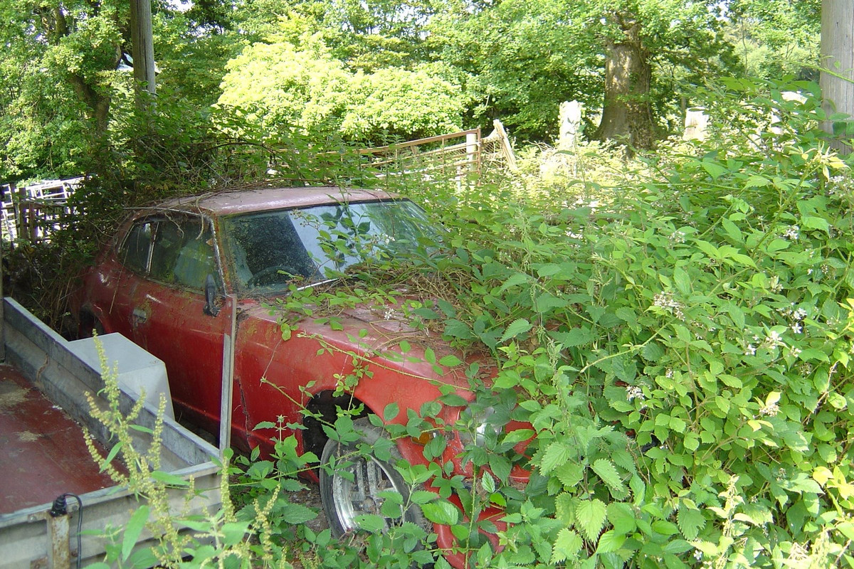

Just been going through this post and I have to say it’s looking really good so far.
I’ve always been a fan of the Datsun Z cars so it breaks the heart to see this sitting forlornly on my friends farm.
F8473-A7-A-EB96-4-E52-AC77-32-C14340-DD2
Share this post
Link to post
Share on other sites
ahh, sigh...lush old green English countryside.
but its only a 260Z not a 240z so its ok :laugh:
probably no bringing that back to life :sad:
