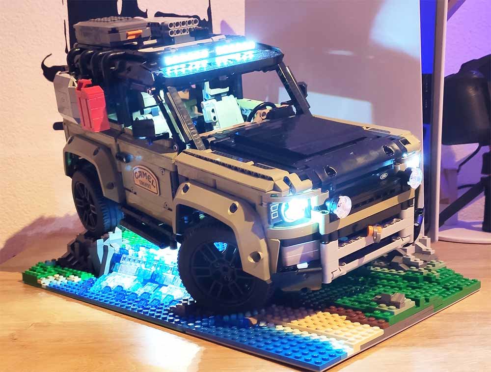

jefniro Posted January 27, 2022 Posted January 27, 2022 (edited) Hello folks, glad discovered this Forum! I love LEGO bricks and the Land Rover Defender has been my first Technic! What a piece of art! I customized as described: - Black Top - Black engine hood - Double side doors platform - Camel Trophy plate - LED lights - Customized front - Environment plate - Double fuel tank unfortunately I can't upload other pictures. Edited March 3, 2022 by jefniro updated Quote
