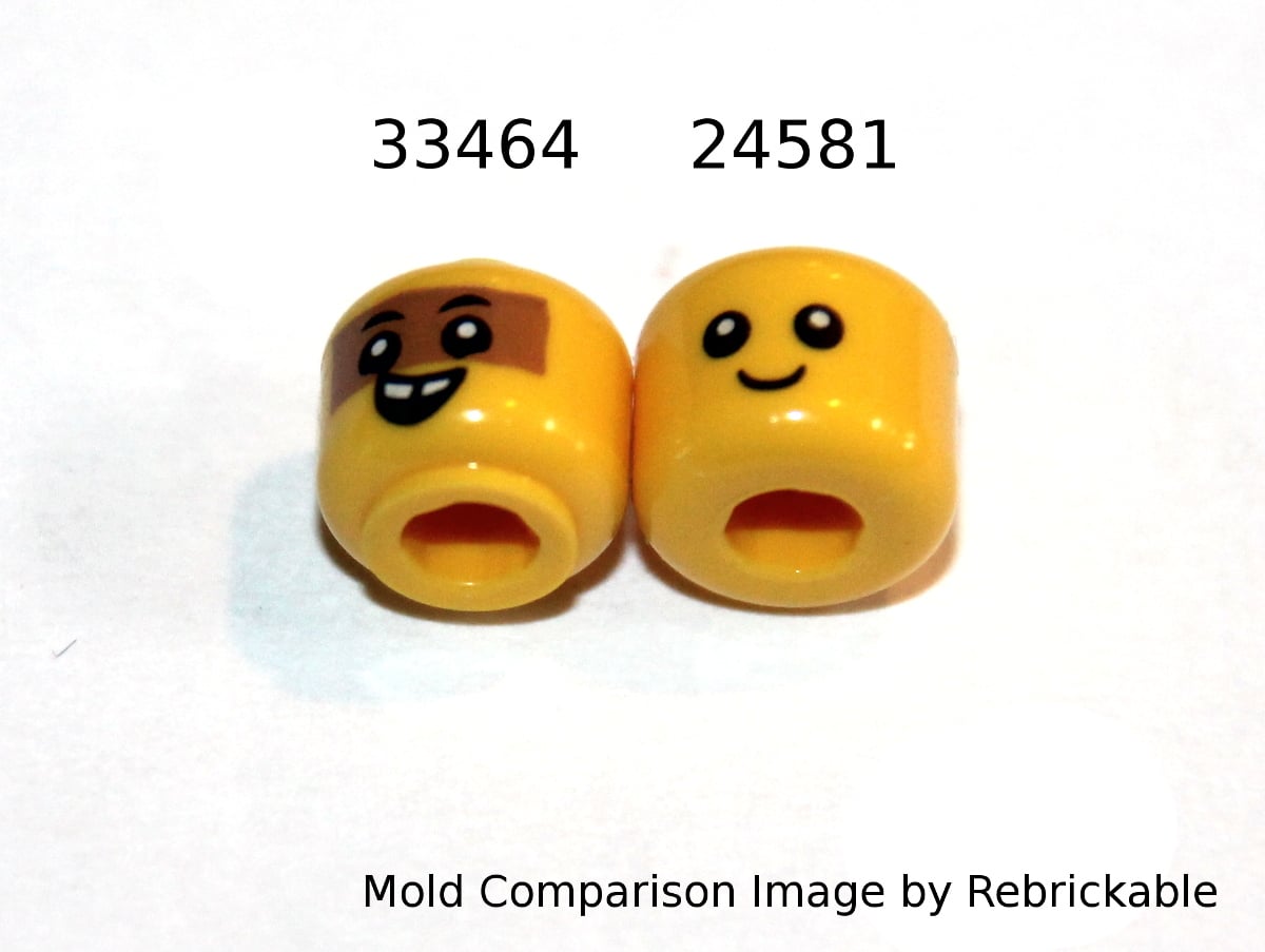

And also the baby head

"33464 vs 24581"
The clam pieces have their own distinct listing in BL so we can say that the community knows the differences between these 2 types exist. From afar, I can't really tell the differences though.
Same with the baby head, they are 2 distinct listings in BL so I believe it is already addressed.
