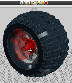

There's an issue with the 92908 Gear Block attaching to the Power Puller tire/wheel assembly. It attaches without problem to the wheel without the tire, but not with it. There is no such problem with the real parts. Can it be fixed?
