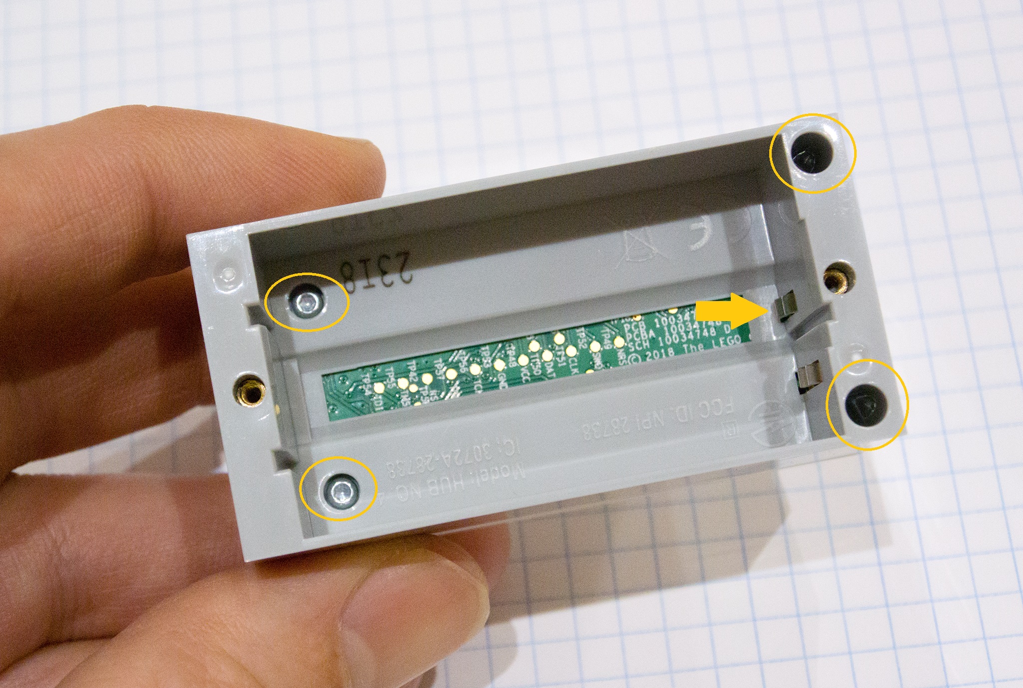

I've already added a second motor to the passenger train, now I did the same with the cargo train engine. It required a different approach. The passenger train has two engines with two battery boxes, thus changing the polarity of the second motor is sufficient. However, the cargo train engine has a single battery box that I wanted to connect to two motors. Although there are two outputs, the remote control does not allow to control both outputs together, so the buttons of channel A and B would always have to be pressed together, which is not a satisfying solution. I'm using the original remote control, thus an app that controls both channel together wasn't a solution either.
What I did was disabling channel B inside the battery box and internally connect it to channel A with reversed polarity.
What you need:
  • Torx T6 screwdriver
  • Small soldering iron
  • Very thin wire
  • Sharp knife
  • A Powered Up train motor
  • Some Lego bricks to adapt the second bogie
First of all, open the battery box. I've marked the locations of the four screws with circles in the image below. Then remove the printed circuit board (PCB) by lifting it while pressing with a screwdriver on the spot marked by the arrow.

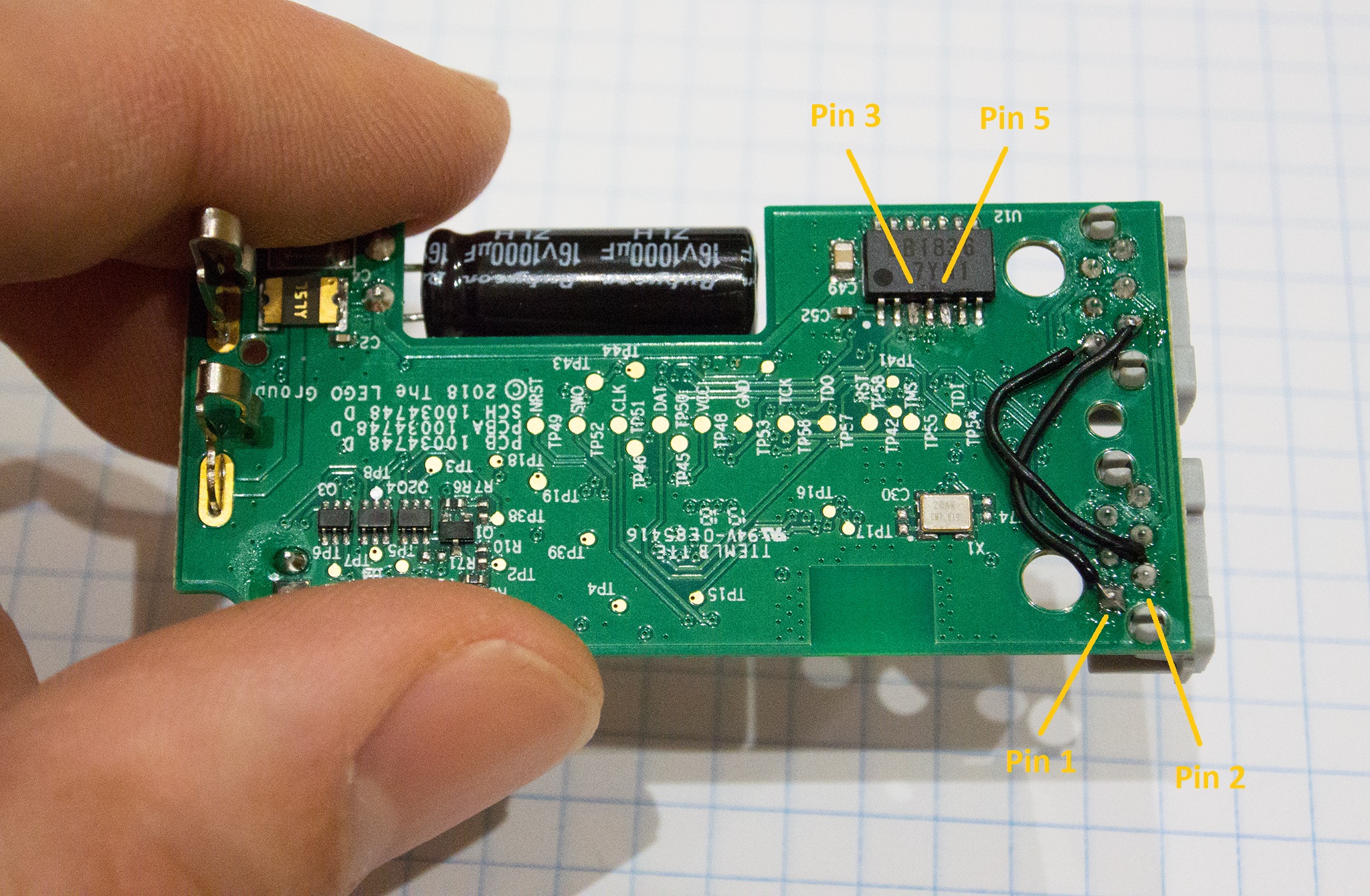

The next images shows the bottom side of the PCB. There is an IC labeled LB1836. This is the motor driver IC. Pins IN/OUT 1/2 are used for channel B, pins IN/OUT 3/4 for channel A. To disable channel B, OUT 1 (pin 3) and OUT 2 (pin 5) must be disconnected from the PCB. I used a knife to cut through the pins and the soldering iron to remove the remains of the pins. Then I've connected pins 1 and 2 of the Powered Up connectors together. I recommend to place the wires on the right edge of the PCB. When placed as shown on the image, the battery box cannot be closed properly.
  • Connection between pin 1 - pin 1 and pin 2 - pin 2: Motors move in same direction
  • Connection between pin 1 - pin 2 and pin 2 - pin 1: Motors move in opposite direction (shown in image)

@legotownlinz Have you stress tested your setup? How is power output & consumption now that both motors are linked to the same channel?
Not really. I tested it a few minutes and noticed that the battery box starts blinking at higher speeds. I think that means the batteries are empty, but they are fresh. I have not checked yet if that also occurs with an unmodified box and two motors.
I measured the current drawn by a single motor at highest speed. It is between 0.1 (idle) and 0.5 (motor blocking) A. In practice, the motors never block because there is not enough traction between wheels and rails. Two motors stay below the absolute maximum rating of 1 A and the motor driver IC has overtemperature protection.
Edited by legotownlinz

Hi ,
why havent you coupled both inputs , then each motor would have 1A instead of two motors have to share one output of the lb1836
i have done this a few times with the v1 ir receiver , it also has the lb1836
i also remove the ptc from the train motor and the electric fuse in the battery box or rechargeable unit , makes a huge difference in traction power especially at low speeds
the LB1836 has its own internal protection ;) one is more than enough
Two reason: First, it was easier to do. I just had to cut and remove two pins of the LB1836. When connecting the two inputs as you suggested, you would have to disconnect one from the microcontroller. Second, I originally planned to connect LEDs to the second output (but have not done it yet, mainly because it would require ugly wiring).
My approach has an issue: At high speeds, the LED of the battery box starts blinking. I've not figured out why it happens yet.
I might try your approach for my next engine to, maybe that avoids the issue.
If the light normally only blinks when the batteries are low, it could be that the box is monitoring the battery voltage to use as a sign of when the batteries start running low. A way to confirm this would be to measure the voltage from the batteries while the motors are under load - I'm not sure how you'd go about creating an artificial load, as it seems pretty impractical to measure this directly off a running a train.

On 5/21/2019 at 7:45 AM, T_H_O_M_A_S said:
Hi ,
I was testing this last night. Except I crossed over the input pins. I connected in1 to in4 and in2 to in3. This resulted in the motors turning opposite directions which is exactly what we need for trains with twin motors. It worked great.
Using the 88010 remote if an input was given to both channels with the input pins shorted together in this way, the motors just stopped. There didn't seem to be any negative affect on the system. However this was tested with two 45303 Simple Medium Motors and only for a short time.
Here is a small data sheet of the motor controller if anyone is interested: https://www.onsemi.com/pub/Collateral/LB1836M-D.PDF

i only whished they had used fets instead of double transistors , less voltage drops and more juice to the motors ;) , you only have 7 to 8 volts available
to avoid motors stalling , cut the input pins on one side and make it a dedicated train receiver
