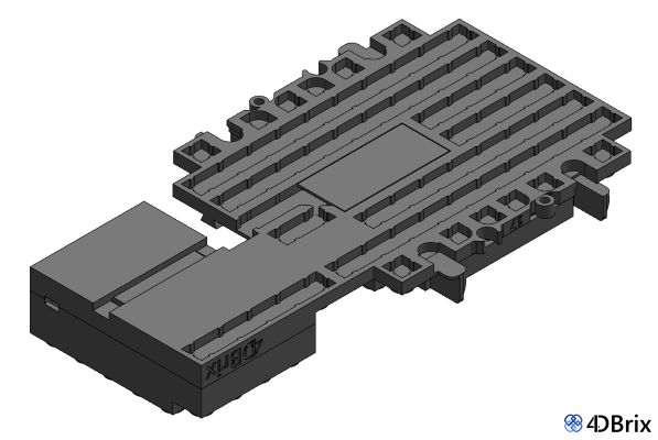

Lowa Posted December 3, 2018 For those who were wondering, yes, I’m still alive! I apologize for disappearing, things have been / still are pretty hectic with 4DBrix. However, I would like to try spending more time again keeping in touch with the community again. I haven’t had that much time to work on new products but I did manage to finalize the decoupler. We made a video to show the new decoupler in action! We redesigned it because the initial decoupler had a few shortcomings: when the train wheels are in front of the ‘claw’ of the decoupler, it cannot be closed. From a distance, it’s hard to see whether the train is positioned correctly or not. Therefore, we added a 'magnetic sensor' to the decoupler. That sensor can detect the magnets of the LEGO train couplings. As such it’s easy to verify the positioning of the train. the initial design had a detachable motor comparable to our track switch motors. That was a straightforward solution but it was 8 studs wide. That meant that, when integrating the decouplers in a rail yard, the motors were touching the neighboring tracks. To avoid that, we integrated the motor into the decoupler giving it a much smaller foot print; that also allowed us to reduce the height. Some additional remarks: For the video, we replaced the PoweredUp controller and motor of the 60198 train by a PF motor and our WiFi train controller. Controlling the PoweredUp trains is work in progress... Positioning the train on the decoupler is not that easy. Therefore we implemented a small script in a generic tile that positions the train automatically based on sensor feedback. In the video, we ‘manually’ parked the train with the first car on the decoupler and then activated the auto positioning: it slowly moves the train backwards until we get a +90% reading on the magnetic sensor. That turns out to work very well. It’s also intriguing to watch because it’s the automation system driving the train autonomously... The hardware is ready and we hope to be able to make a first batch of decouplers the coming weeks and the release it… From the software side we might have to make a few extensions to the train control panel to improve the control of the train at low speeds, but the basics are there. As usual, let us know what you think! Share this post Link to post Share on other sites

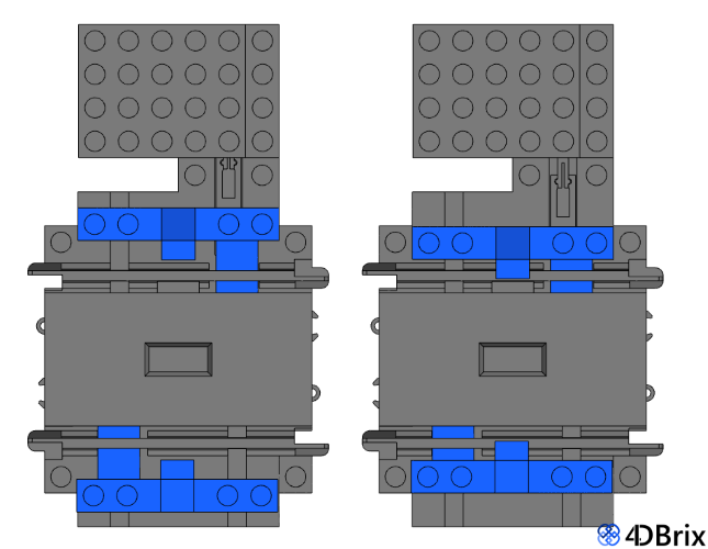

Lowa Posted December 3, 2018 4 hours ago, Roadmonkeytj said: This is brilliant.... Are there other videos of the mechanism? Thanks! I think the redesign was worth it... I don't have any additional movies at this point. I have to make a close up of the mechanism when we actuate it. The images below show the decoupler in the 'open' and 'closed' state. It holds the cars in place by blocking the wheels. We felt was the most universal solution that should work for all standard and custom cars. Share this post Link to post Share on other sites

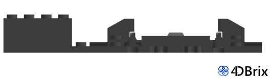

Lowa Posted December 4, 2018 I got a few private questions that might interest some of you: 1) Do you need to raise the track to install the decoupler? No, the base of the decoupler is flush with the base of the tracks. This is a side view of the decoupler 2) Can you ballast it, i.e. does it have anti studs ? Like all our other tracks (we remodeled all of them) it has the maximal amount of anti studs possible. Some areas don’t have anti studs because the internal mechanism doesn’t allow it. We preferred that over increasing the height of the decoupler. The image below shows the anti studs, all anti studs are fully functional. Share this post Link to post Share on other sites
