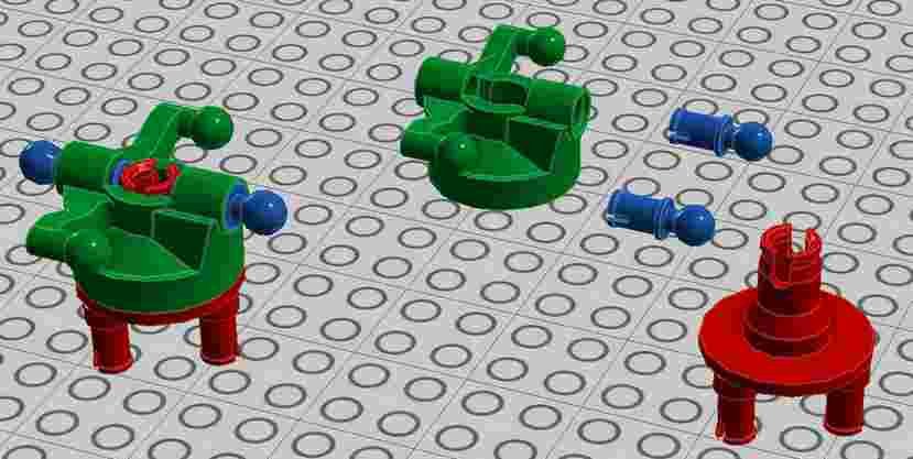

Does anybody have an alternative method of creating this part (or one that has the same function), seeing as it doesn't exist in LDD, please?
This is the part in question: https://brickset.com/parts/4227853/lt-wheel-bearing-w-3-snaps
I'm currently just messing around, building the Ferrari F1 from the Racers set. Any help would be greatly appreciated. Thank you!

It is probably not what you want but this is as close as I could get. Parts are 11949, 92909, 6628.

Thank you, swijak. It's very close, I might be able to modify the rest of the model somewhat, to make it fit.
Bloody LDD. It's frustrating how often you come across parts that are missing. But it's so easy to use.
