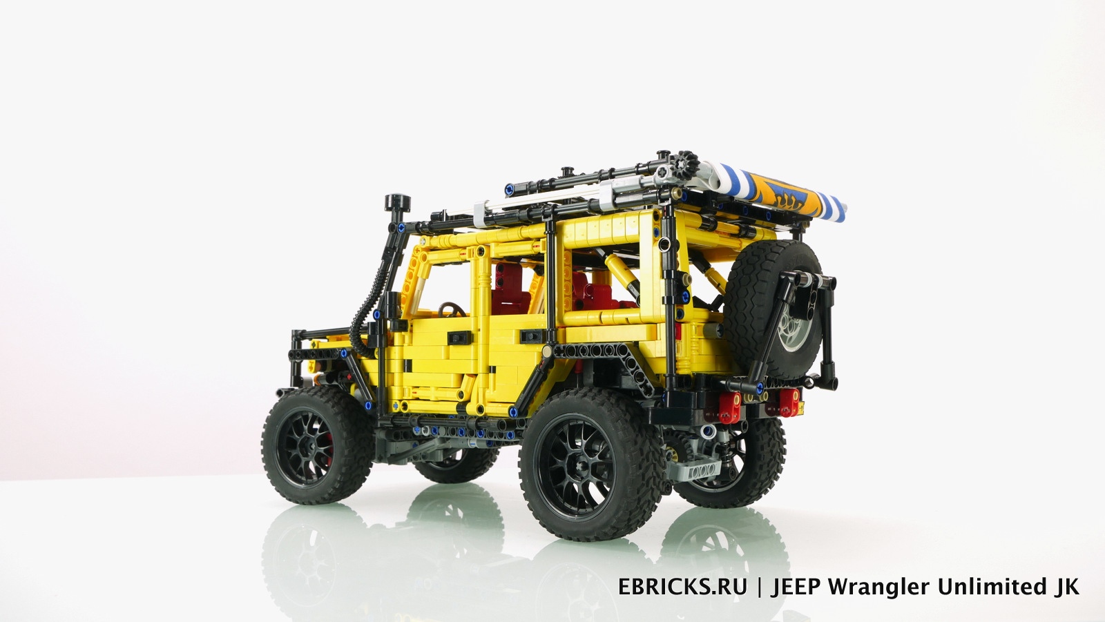

Hello,
Madoka's JEEP Wrangler for me is most beautiful JEEP build from LEGO ever. That was a love from the first sight. And it is also fit my favourite scale - 15 stud wide body, like my Toyotas.
Since I saw it - I want it on my shelve. Comparing to Madoka, who's every new model is a Challenge and he never use previous model's elements (no matter body design or internal structure of chassis), I am quite conservative. My every next model is evolution of previous if talk about chassis. Madoka's JEEP Wrangler chassis is awesome, but I prefer my own with springs, links and gear rack steering.
So I stretched his Jeep from 3 door version to 5 door,  added rear seats with foldable backs. Put it on the Hilux chassis with minor changes and that's my "own" JEEP.
specs
- Driving - XL motor
- Steering - Servo motor
- Body removable from chassis
- Openable doors
- Removable 2 section hardtop roof
- Suspension on both live axles
- 4x4 transmission
- LED lights
- Smart Brick for RC with iPhone / ДУ через Sbrick
- 1 stud lift possibility
- Winch is fake (like all beautiful things in modern world:))
The hardest part for me was rear doors. That sounds funny, but making them tapered with the right angle was impossible using standart angle connectors. So I have to cheat and use LEGO System bricks and inverted slopes. No, I never miss this bricks while playing Jeep, but this element is still bothering me. May be someone could offer better design - I will be glad to use your idea.
Front axle is little bit long, shifted forward may be half or one stud, than should be. But this was done to fit larger wheels, because stock wheeled JEEP Wrangler is the worst looking offorader in the world, especially long wheelbase version:classic:
I also left possibility for body and chassis to be connected on two ways: standart and 1 stud lifted.
This is lifted verison with 74 mm tires from RC4WD
Jeep is modular like real model with removable doors and 2-section roof, thanks Madoka for design. Front lights are still LED ready.
Expeditional stuff increases the weight of the model, but this is Jeep's calling to be like that.
Roll cage, roof rack, spare wheel holder, baggage and cans, fake winch, extra lights, snorkel and extendable rain/sun tent.
With minor changes in the axles, model can stand on RC 1:10 tires that have wide variety to choose from
And my favourite: Buggy Mode with RC4WD Mickey Tompson Baja MTZ tires about 81 mm diameter.
And this is not just shelve model, because Jeep without roof and doors is really light. If you put Buwizz in it - you will have a lot of fun with it ;)

Thank you for feedback.
13 hours ago, zux said:
Video shows model getting stuck on sand with just one wheel spinning. Is your transmission with all open diffs?
Are those fancy disks/rims 3D printed?
The problem was with one of front CV's, in the simpe words: I lost front axle drive :classic: Problem was with steering knuckle. Now it is solved.
Those Wheels are from 1:10 Touring/drift/rally RC cars.
