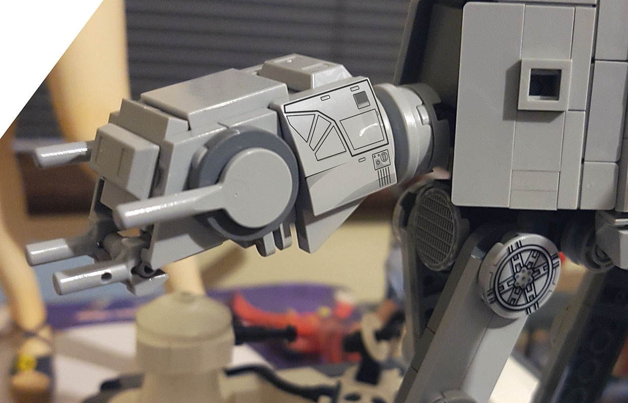

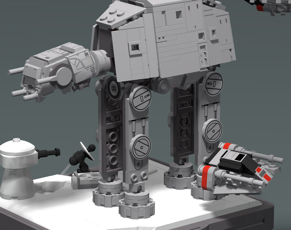

Looks ok enough.
I'm preparing my artwork, but I think I may have done some lines too thin for those printers.
On the other hand I have the full side of an AT-AT head to illustrate on a 4x4 slope..
But I'll be happy if anyone can print this like in my quick mockup.
I have already contacted steindrucker, which is a neighbor country (BrickSanity is a neighbor as well, though).
I have 28 parts with 9 different designs, I guess that pretty much prevents pad printing. And that's by already making knee disks & leg pistons generic enough that I can repeat them.
Steindrucker mentions 5760 x 1440 dpi printing btw. I'm not sure all of the parts in his showcase look like they're ultraprecise, but some definitely do. (most are cheesy but hey, it's not what I'm judging).

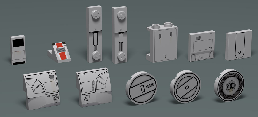

So I have contacted Steindrucker and I now know that I got my artwork in the wrong direction.
I thought I'd go for transparency for shadows, so that I'd put less ink on the tiles and they would keep their original "shine". That is, I'd rather have a tile covered in halftoned black, rather than fully by grey, also because I'm pretty sure it'd be hard to match the part's base color with the printer's ones.
I could half-tone the shadowing myself of course, but there's a chance it's gonna go wrong the closer I get to the printer's DPI.
I fully understand that pad printing needs every color solid, though.
Anyway, I know what I need, now the question is still who & at which price.
