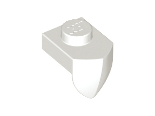

But now I have a problem that I do not know how to solve. It is on piece 15070 of LDD (attached photo). This piece does not have an alternative reference code in bricklink, and of course, LPUB does not recognize it, and it does not appear in the instructions.
As in my design there are many 15070 pieces, the result in the instructions is very ugly..
What alternative reference could you use for LPUB to recognize this piece?
If there is no alternative reference, what solution has this problem?

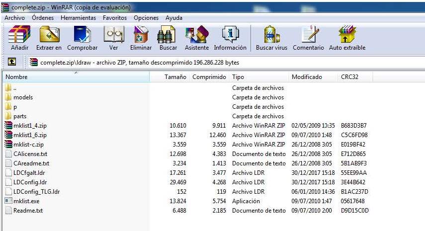

Hi. When I click on complete.zip I get what you see in the picture I attached.
I simply copy the folder that says "parts" and replace it with the one I now have in my LDRAW program that says "parts"?
Or do we have to do something else?
Thank you.
Share this post
Link to post
Share on other sites
Replace everything.  Granted, Readme.txt and licences are the same but all the other files are important too (e.g. p contains primitives).
