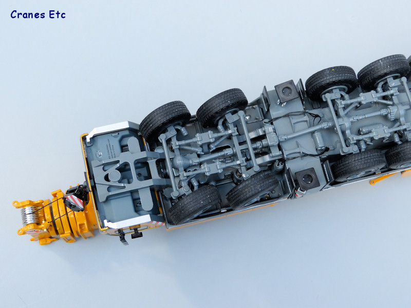

I think I've found your problem. With virtually all cranes I have seen, the outriggers actually retract past the point you have them at. The back of the outrigger box is actually at the opposite side of the crane. To point you in the right direction, here's an underside view of a model crane with similar outriggers.
If you look at the outrigger box, the outrigger piston actually goes past the back of the outrigger behind it. So, your assembly will be a bit longer, but having your outriggers retract in this manner will make it narrower.
Share this post
Link to post
Share on other sites
Ah yes!  I even looked at a model crane and totally missed that. I guess I was relying on 42043 outriggers and not realizing that isn't how crane outriggers really work. Thanks for informing me, time to start working on outrigger version 4.0? 5.0? Idk I forget
