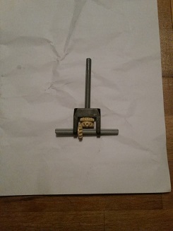

Hi, I can't quite make out the gears for the perpendiculation in the video. Is the arrangement in the image suitable? It uses 3 single-bevel 12-tooth gears.
Share this post
Link to post
Share on other sites
I used instead of the 2 single bevel gears, 1 double bevel.
Share this post
Link to post
Its probably better if you remove the back bevel gear and replace it with a half bush..
