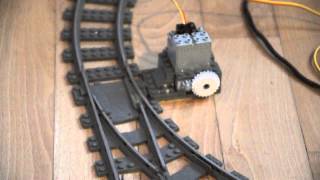

As far as I can see from your pictures the pneumatic cylinder turns a technic liftarm that moves an 8 tooth cogwheel on a rack that moves the switch?
I have found that motors do the same job as long as the rack can be held in place (it is merely resting on top of the switch) by the 8 tooth cogwheel. If you have space underneath your rail, the motors can be hidden. I guess you could do the same with the pneumatic cylinder. Have you tried using the small pneumatic cylinder?
See my Flickr for a motorized version (rails are mounted 2 bricks and 1 plate over the baseplate):

All my switches have different ages and "pressure points", after some testing only 2 of those worked somewhat reliably with the design i had which is a adaption of this:
I have a bunch of old 9V Technic motors (1990) with different levels of wear and performance, see here:
The 2 switches i used ended up working 2/3 of the time. The problem was not jamming but simply not enough power. According to this chart it only has roughly half the power of the motor i should have been using, but so far have never seen in sets here in germany (maybe missed them due to dark ages). Sometimes it would help to rapidly move sewsaw style to get it to switch to the other position. Sometimes the problem seemed to be not the motor but the clutch gear giving way to early. I settled for replacying the clutch gear with a regular gear on one of the switches, but that only helped a little.

Yes, but I also don't like the visible gears, so for a couple of my switches sits a house over the little motor. The obvious disadvantige of any solution that is built above landscape is that it looks bulky and has to be built quite close to the track, thus eliminating the possibility of overhanging trains and cars.
I have also tried the "spear" solution where you don't have to modify the switch at all, but use a minifig spear to push on the little moving piece of the switch (I don't have good name for the part on the switch), but again, the motor that you have to use will have to be hidden somewhere.
I will defenitely look into the pneumatic solution you have posted, as this for a small area can be a viable solution. If you elevate your track at least 1 brick, you will also have room for the tubing.
In conclusion, I think that my layouts in the future will always be built a couple of bricks above baseplate, at least where there are switches. This is of course brick demanding, but hey, then you can add small slopes and gradients that in the end will make your layout look more real. After all, earth is not flat :laugh:
That is correct. Pneumatic cylinder -> 2 x liftarm (arranged in an L-formation) -> 8 tooth gear -> gear rack
I tried the small cylinder, but failed. I can't remember why at the moment though... :) I'll probably have another go at it soon enough.
If I had seen your pictures before I might have gone that way. It looks brilliant! I'll have a try with pneumatics one day.

I found that the only way to get it done by motors was to build an enormous 'holding cage' to ensure that the power needed didn't break the construction. In the respect I have to say that baard put me to shame in a brilliant way. :)
In my experience there is no way to have reliable automatic switching without raising the track. The bottom is too weak.
