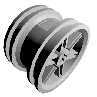

Thanks, and yes it is rather fast, I think approximately 13 km/h. If you do use the tire squeezing idea, make you use the older rims that do not have four reinforcement struts or else the tire will not stay in place.
This is the older version of the rim. see how there is no extra ridge going from the top to the bottom of the rim.
This is the newer version of the rim. See the extra connector piece.
