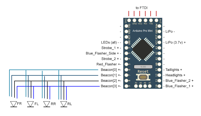

Hey M600, hope you're getting the notifications now...
Everything's arrived, so I'm starting to gear up to make this. I've started doing a circuit diagram for my own clarity, as I've never worked with an arduino before, so want to get everything right first time... I came up with a few questions:
- The LiPo +, I assume goes to VCC, unless it's considered unregulated, then does it go to RAW?
- Terminals 2-9 are supposedly Digital, whereas 10-13 are Analogue... Does this mean that 10-13 should be returned to the GND that the LiPo is connected to, or do they all go to GND on the digital side?
- Does the FTDI require soldering in to program the Arduino, or can the contacts be loose? maybe should solder in a female header?
- Your roof is attached by a single wire... is this just a braid of wires (5-11,GND)?
- I assume the Delays in your Startup sequence can be reduced, or is this any kind of requirement on the Arduino?
- Is there any way to program in a check of the input voltage, so as to warn (or flash an error code) if the LiPo charge is low?
- Any recommendations on software to use to connect via the FTDI (I'm on a Mac)

Hi,
NOTAIDAR:
- The lipo run at 3.7v which is fine to go directly to the RAW input of the board (positive to RAW, negative to GND). Tbh, mine is on VCC but you should use RAW.
- Analogue or Digital is not relevant to the fact you should ground them or not. It's an output pin that can be for the analogue input or output and set a different state. Where Digital only got for output and can only be on or off.
- You don't and you should not put header since you won't have the space in it to fit the assembly. Either solder wire and desolder/cut them. Or loose connexion is fine if you can make it steady while it's uploading.
- It's a self made connexion with 8 pins (number 5 to 11 pins) 8 wires twisted together. (Huge mistake possible here).
- Delay can be reduced at your taste or even removed completely. It was what look like a starting car for me. Can be changed without any fear.
- I don't have any sort of control on that but maybe rerouting the VCC to an analogue then make a function that will monitor it and trigger a deep sleep might do the trick.
- Arduino standard IDE is perfectly fine for that (that's what i'm using to upload in conjonction with Atom text editor for the color coding. Arduino setting with external editor).
Your sketch is almost good. Only the Beacon part is wrong. When the line say
constint beacon[] = { 6, 7, 8, 9 };
It mean that pins 6 of the Arduino goes to the positive lead of the first LED (for all 4) of the beacon. Pin 7 goes to the positive lead of the second LED (once again for all 4 beacon). And so on for the 2 other. All the Negative of those LED goes to GND.
In summary:
pin 6 ---> 4 positive lead of LED Beacon 1
pin 7 ---> 4 positive lead of LED Beacon 2
pin 8 ---> 4 positive lead of LED Beacon 3
pin 9 ---> 4 positive lead of LED Beacon 4
GND ---> 16 negative lead from the Beacon
Hope it's a bit clearer.
In summary:
I think perhaps that's an error in my diagram. I understood the meaning originally, I should have identified each of the FL, FR, RL, RR symbols as a cluster of LEDs, rather than as an individual LED symbol.

1. In NOITAIDAIR's circuit sketch he has the board and a section labeled "to FTDI" so I was wondering what this means. But I think I now understand it's just the connections for programming.wiring.png
2. I have updated the code now to your new code and reprogrammed my board. I'm new to Adruino and have a lot to learn. What is the purpose of the PCB board located in the roof of the car?
