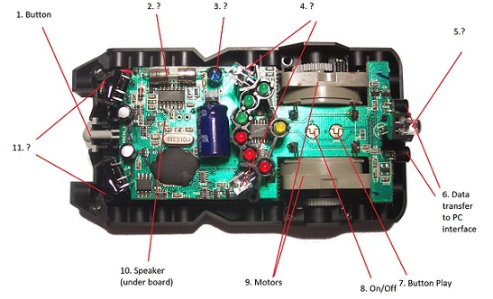

Now more interesting things that I recently discovered :)
You could fit NodeMCU (arduino like with wifi)  to the box. It will need microusb hole, for uploading programs, and could run motors (on 3v) without shield. Making new board and moving components to it, could ad new live to the units.
I attached image of internals.
  1. Button. Completely coupled with case and board. Could be used to detect touch with adding technics parts.
  2. ?
  3. ?
  4. ?
  5. ?
  6. Optical interface for data transfer.
  7. Button play.
  8. Button On/Off
  9. 2x motors.
  10. Speaker attached bottom of the board.
  11. ?
  12. 7 leds (3r, 3g, 1y)
What i learned from internet (http://www.bricksinmypocket.org/2009/06/spybotics-internals.html), there are next components:
  • light sensor
  • 2x IR receivers
  • laser LED (VLL)
  • 4 IR transmitters
Any ideas what is what?
