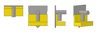

CopMike Posted February 26, 2014 Posted February 26, 2014 Hi all! Sorry if this has been explained elsewhere, I´ve tried looking after answers a bit but gave up. So instead I´ll post my two problems here ! First - Is there a way to find which brick is where? The reason for this strange question is that I built a rather large thing and accidently used two BRICK 1X2 WITHOUT PIN instead of BRICK 1X2 (which for now is 70 used). So I´d like to find out which two are the wrong ones to be able to change them. Second - How do I connect a minifig shield to a panel like this? Thanks! Quote
CM4Sci Posted February 26, 2014 Posted February 26, 2014 1. Type the part number? 2. This should work. Hope this helps! -Sci Quote
