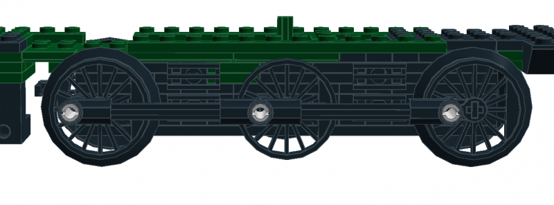

what is the maximum wheel distance apart that we can go of fixed wheels without the train jumping tracks?
I am using the large flanged wheels as used in the Emerald Night.
thanks
On my BR 65 this is the distance:
BR65 Drivetrain by Duq, on Flickr
It kinda works but is not reliable. Ideally the flanged drivers should be closer. Unfortunately on this loco it would mean an enormous overhang.

@garethjellis: There's a distinction between maximum distance and distance at which scraping becomes unacceptable. I probably wouldn't do more than 10 or 11 studs axle-to-axle (i.e. measured between the centers of the axles).
It really depends. 15 holes apart is possible in curves. The real problem are the switches. I just tried it out and it works fine with 10 holes in between, but I have the 9V switches, don't know with the newer ones as they changed something (if anything, it would work better).
I built a 2-10-4 with this FBBF wheel spacing (or in my case BFBBF). Testing under ideal conditions went flawlessly, so I went forward and finished the train.
But running the locomotive on my ballasted track proved less successful - it started grinding in curves, so I had decided that the FBBF wheel spacing was too much. I abandoned the train to only be decorative, stripped out the motors, and went on my merry.
But now, some two years later, I discovered a flaw in my ballasted track, where the curves were resting on exposed studs, causing them to twist. I've since fixed the design but have not had a chance to revisit my 2-10-4.
It may be viable after all.
In any case I wouldn't suggest any larger spacing between flanged drivers - the FBBF spacing is pushing it.

Hey Tony, my experience was similar; in lab conditions all seemed fine but real world at a show wasn't as reliable. Especially points can be tricky. I haven't had a chance to do some troubleshooting to try and improve the engine.
For the moment though I won't use FBBF again in a hurry. The problem of course for engines with 4 drivers is that the overhang at the front or back will be enormous. For my BR 55 I went for BFBF. I needed to keep the rear overhang to a minimum to keep it close to the tender but it means at the front it swings out 4 studs past the sleepers...

One thing with the FBBF on curves, if you were running on 9v track I bet you have better luck going clockwise than when you go counter clockwise. The rail connectors are not flush and provide an opportunity to climb the rails when the outside rail is on the right hand side, but no problem when the outside rail is on the left hand side.

That is just a brilliant little drive train, from the compact gear box to the axle connectors to deal with the otherwise non-integer axle spacings
