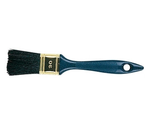

I found this worked best for me (to prevent washing)
Every now and then I toroughly remove any dust by vigorously "brushing" all the surfaces while holding the vacuum cleaner close to the brush
