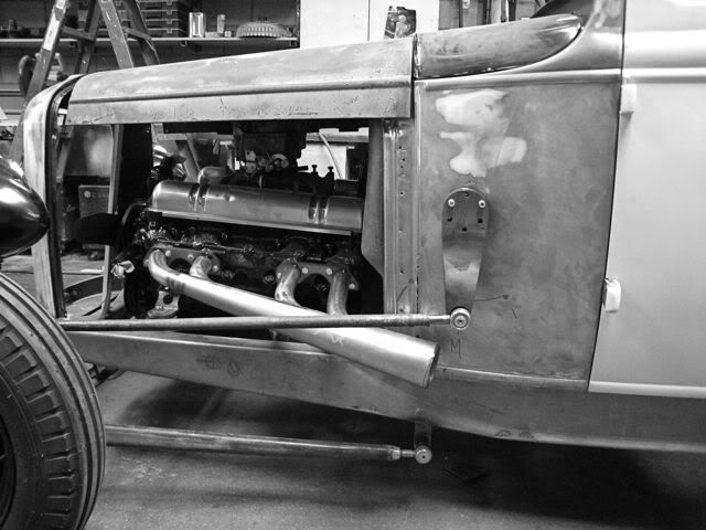

the pitman steering can also act like a panhard rod - or you can install it at right angles to the live axle like so:

I have to admit .. I kinda wanna build a hotrod just to test that steering setup :P
