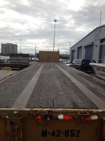

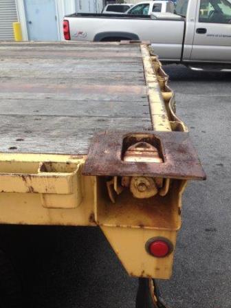

Thanks for the tips and replies 2LegoOrnot@Lego... Let me see if I can get a picture of each, the leg "crank" and the brace for wood. It would make it easier for all of us to discuss.
Thanks again and I'll try and post them in a few hours if I can get them.
Even tough my English is not that bad, I have no clue what it is that you mean with a crank in this case. I know of a crank when it comes to a engine, but in this case…you make me wonder! Please explain.
I think it is referring to the crank that's used to wind the trailer legs down, correct me if I'm wrong:
@Azzepa you are correct
The picture will show the crank and the small support beams that drivers will use to store wood to place under loads when using forklifts to unload them.
This picture shows the decking of a trailer, its a mix of wood and steel beams.
these pictures show the newer trend of adding container locking pins on the corners and at the 40' marks.
