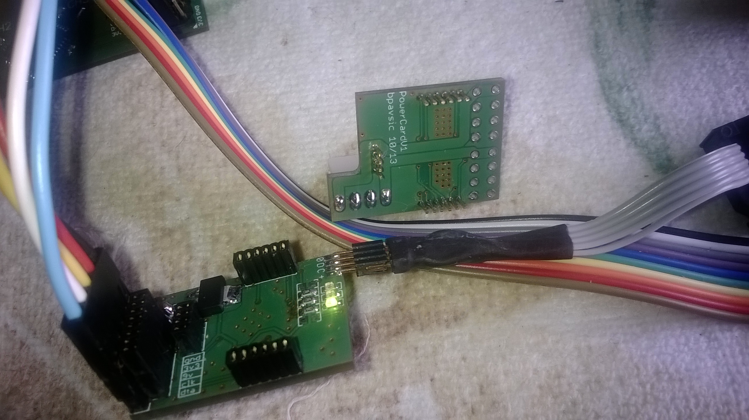

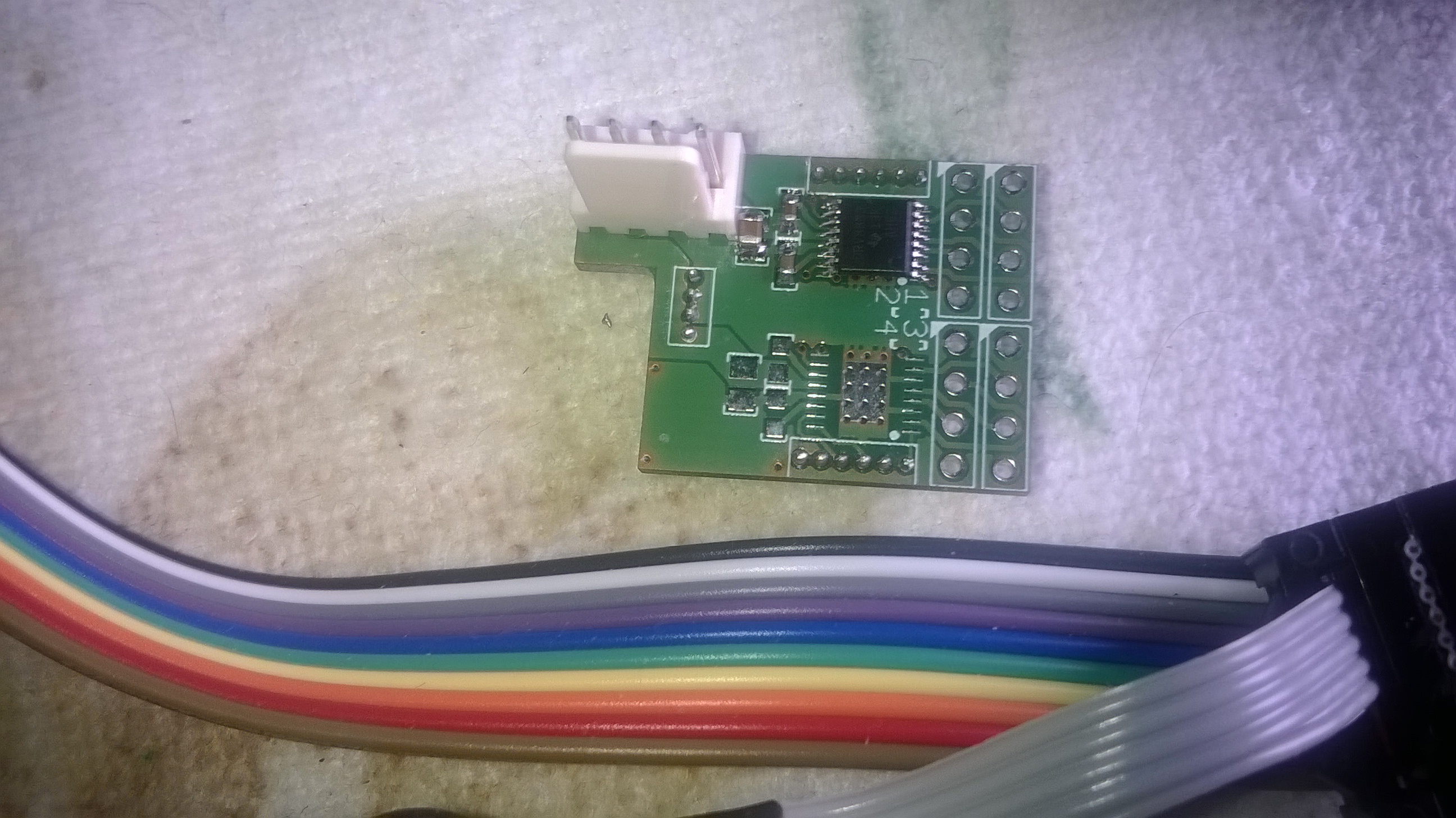

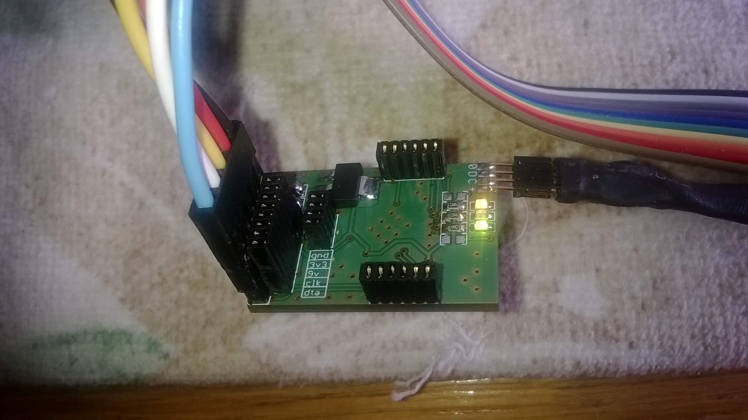

Bojan Pavsic Posted November 14, 2013 Posted November 14, 2013 (edited) Since i'm very much involved in our LUGs displays, i have some experience in different Lego train technologies. There is 12V which is perfect for displays, but costs a little fortune and has some weaknesses with track contacts and pickups. Then there's 9V which is still used a lot in displays. There's quite some interesting options (ME rails, 9V motor repairs) but lacks the "control" of the 12V. And ofc, it's obsolete from TLGs point of view. Basicly if we wanted to go with the flow of time, we had to switch to PF. But a new problem came into view because we don't only display city/train dioramas. There's Technic too which messes up with the PF channels. After some thinking, tinkering and designing, we finally have a promising alternative for PF trains. I tried to keep everything very affordable and as small as possible and the result are a couple of modules that make our dioramas more interesting to the public (especially the kids) and have a lot more control. Let's cut to the chase... Some highlights: - The whole system works with RF (radio frequency) at 2.4 GHz. The frequency can be set from 2400 MHz to 2483 MHz in steps of 1 MHz (but can even go up into the 2500 area, so it doesn't interfere with WiFi & Bluetooth). They can be "hidden" inside creations, since they don't need the IR sensor to be in visible range. - RF transceivers (transmitter + receiver) are used, so 2-way communication is possible (thou not yet used, but there are some ideas). - Custom LiPo batteries that are smaller, can be recharged faster and have higher capacity then TLGs. - Multiple control options (tablet, phone, pc, ...) - Modular. First there is the IR receiver replacement (the little connector on the right side is for debugging & programming... isn't there in the final cards). It's a PCB with dimensions of 21 x 29mm (3 x 4 studs minus 1.5 mm on each side, if maybe there will be a 3x4 case made). It has a 3.3V voltage regulator, a 32 MHz micro controller (Atmel Xmega16D4), 3 status LEDs (1 is power, other 2 are for info / status / lightshow ). There's a connector for wire communication (I2C) and power supply. Another connector is for the communication card (currently it's a RFM73, but there will be an IR card too - for PF compatibility). It also features 3 headers for a "daughterboard". Let's call this module the "receiver". The second module is the driver card (it's an old picture, that doesn't have both driver chips and output connectors soldered yet). It is the "daughterboard" for the before mentioned receiver. It features two driver chips DRV8833 (same chip that's built in PF IR receiver V2), which makes it possible to control 4 motors (twice as much as the original PF receiver). It also has a power connector with separate pins for each driver chip (2x up to 3A power supply). A picture of both cards next to eachother. There will be different modules in the future: 10 LED channels for lighting or semaphores, 2 motors + 4 LEDs or servo + LEDs for track crossing or track switches. The third module is the "control" card which has 4 RJ45 connectors (network) with 6 input lines + power supply in each of them so 24 inputs all together. 4 boxes with buttons can be connected to it. They're ment to be put on the "keep away" fences in front of the displays. When a button is pressed, the microcontroller send the command to one of the receivers over the cable (for non-moveable motors like a windmill or anything that's not like a train) or over RF to a receiver inside a train. The command can be preprogrammed with a timer so it switches the motor off after let's say 30 seconds (That's a win-win because kids LOVE to press the buttons and check what they do, on the other hand the motors are not running the whole time of the show which lowers the battery usage & spares the motors). The "static" motor receivers use the PC ATX power supply (with DC-DC converters to lower the 12V down to 9V). The power supply part includes some LiPo cells (1200 mAh) with a 2S LiPo protection circuit. Dimensionwise it fits into an AAA battery box with half height (basicly it's a 4 x 8 x 2 block). Cells can be charged with 5C, discharged with 15C, so plently of power :) I'll switch the 2S PCM with some BMS (BatteryManagement) that will make it a "smart battery" with all the info that a phone or notebook battery has (cycles, temp, max. current etc..). It will be possible to notify the user when some battery will run out in a train etc... I made a usb stick with the RF transceiver too, so everything can be controlled and setup from a pc. WIP is a WiFi module with a web server that will be enable connections from any mobile device (notebook, tablet, phone) and control & setup everything. Another WIP that i'm currently working on is fitting the train engine receivers with a MPU9150 module (3-axis accel, 3-axis gyro, 3-axis compass) from which i'll try to get some usefull data about the x-y location (i hope i can get good enough data by using kalman filtering on the sensor data and correct the errors that will skyrocket after 2 integrations: accel -> velocity -> position). Here's where the 2-way link will come in handy because if the positioning will work as i hope, then there's a posibility of "auto-pilots" for trains, that will watch over the train compositions so they don't colide. Anyways... it's a WIP, just wanted to see if anyone has some additional ideas what could be useful to have in this system. p.s.: We have a display this weekend, i'll make some additional pictures from there (the system in action). Edited November 14, 2013 by Bojan Pavsic Quote

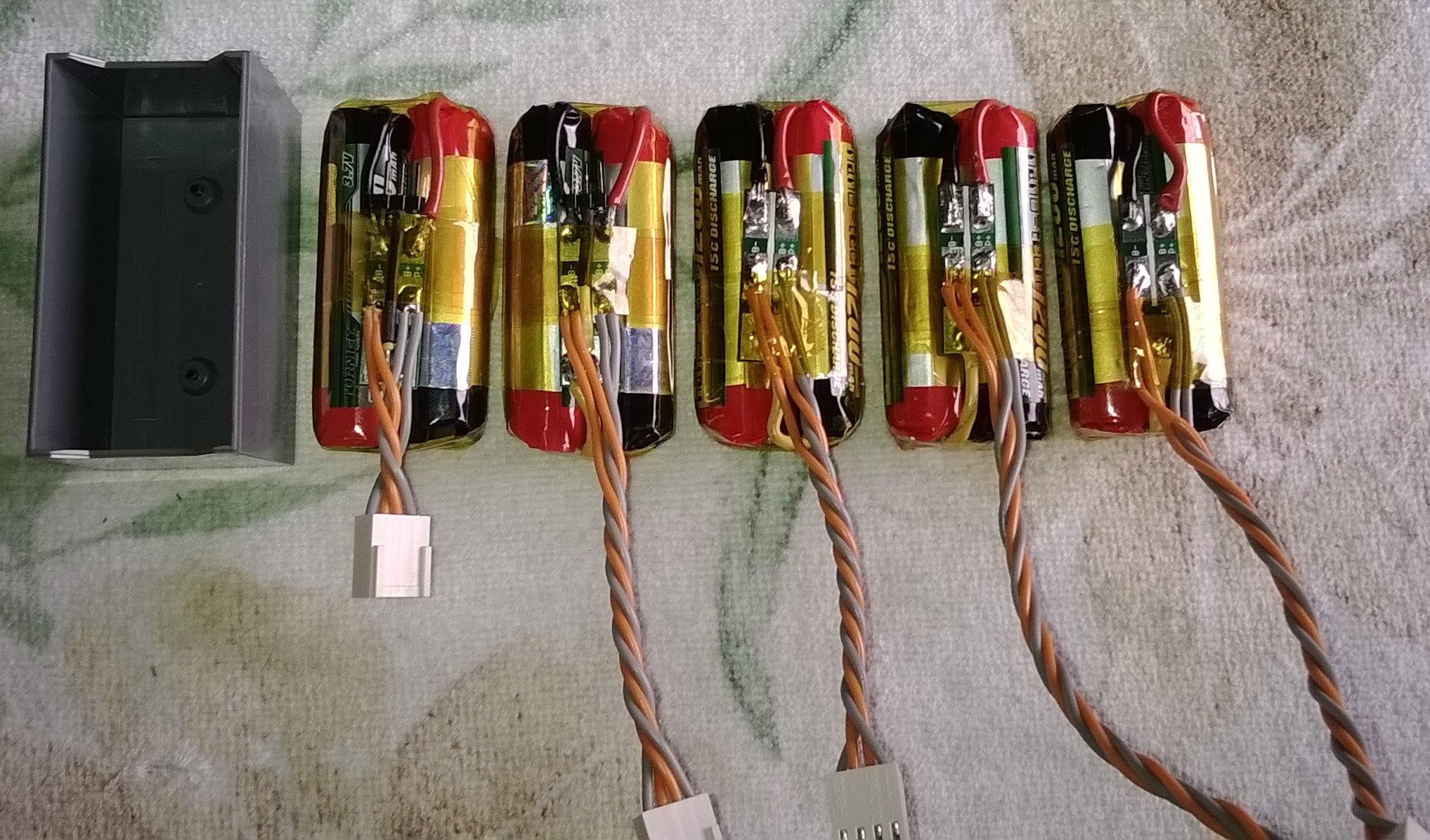

Frank STENGEL Posted November 14, 2013 Posted November 14, 2013 Amazing ! Basically a wholesale replacement for IR. What interests me the most is the battery system. I have toyed with lipos before, but have failed to find a protection system for them... Quote
Bojan Pavsic Posted November 14, 2013 Author Posted November 14, 2013 Not sure if i can post an ebay link here, but it's the SM157 LiPo PCM. China made :) But i already got sample ICs from TI and i'm planning on building a full blown BMS with primary & secondary cell protection, gas gauge, sm-bus (which is basicly i2c that already exists on the receivers so it can gather battery data and send it back...). The cells are Turnigy nano-tech 1200 mAh which are used for hobby/model RC planes, cars etc... Well, yes, it's a replacement for IR (the RF cards support up to 5 byte addresses, so basicly unlimited, compared to 4 channels with PF). But i will probably make an RF transceiver pin-compatible IR sensor that can be used to use the receivers with the original PF controllers. Another thing is to replace the PCBs in the original controllers to add support the RF cards, but currently i only have tin plated PCBs and for the controllers should be gold plated (since it has button contacts...) Quote

Bojan Pavsic Posted November 14, 2013 Author Posted November 14, 2013 @freakwave No, i didn't. Tbh, i switched from PIC to Atmel some time ago. Atmel also has some RF series, but tbh, these uC are hard to get and cost more. About the spectrum. I was checking out 433, 868 and then switched to 2.4gHz... Reason: cost of the RF modules. I bought 100 pcs of RFM73D for about 120$. There's an alternative too... NRF24L01+ which has a different connector (2x4 @ 2.54 pitch while the RFM has 1x8 @ 1.27) but is pin to pin compatible. Even registers and everything is like 99% identical and these can actually be bought for less then 1€ a piece (thou it's slightly bigger overall). At first i wanted the same (retrofit - exchange the PCB in the IR receiver), but then i actually wanted it smaller then the original so it could be fitted in a 4 stud wide model (by using panels on both sides). That's why i settled for 3x4 dimension. @JopieK Yea, those aren't bad, but i wanted a custom board. It'll have full PF compatibility if the IR communication card will be used. At some point over the year, i made a PCB with an ARM processor (LPC 1114) which is an Cortex M0 microcontroller. I took the small one in QFN package (5x5 mm) and i also had the drivers on the same board with additional 4 mosfet outputs (so 4 pwm motor + 4 pwm mosfet for leds & stuff). I scrapped that because it was hard to solder (thou i have hot air station). The biggest problem on a board this small are actually connectors. The power supply has to support 6 amps (each driver has two 1.5A outputs and there's 2 of them). The motor outputs have to support 1.5A each. Even AWG 22 or lower flat cables are soooo hard to find (practicly there's none, at least not any that i found). I'd like cables that TLG uses, but can't find any that would support 1.5 amps. XBee is nice. But costs a lot. What do you mean by concurrency capabilities? How many can be controlled at once? Didn't try more then 2-3 for now, but since the RF comunication goes up to 2 mbps and i'm sending like 6 bytes, the transmit time is very short. And the RF modules have built it retransmision and acknowledge, so no worries whatsoever. @dr_spock Well, depends how your switches are motorized :) If it's PF/9V motors, then yes, ofc it can. But i'll add another part that will support RC model servos which can be very small (i have some in dimensions of a 1x2 brick - will try to control switches with them). I'm getting a 3D printer in a couple of weeks and i'll try to print some housings for the receivers and some lego compatible RC servo holders etc... Quote

Bojan Pavsic Posted November 18, 2013 Author Posted November 18, 2013 After the whole weekend "testing" at our local LUGs Lego event, some minor glitches came to the surface. The motor driver chip has a Chip Enable line, that has to be pulled up to enable the chip (it's a power saving feature, so u can disable the whole driver if not needed). The thing is that the driver works at 9V and the micro-controller works at 3.3V. A "1" from the uC can cause problems in case of little voltage drops (especially when multiple motors are driven). We had 12V LED strips powered at 9V too and the these voltage drops caused the driver to disable which again caused flickering of the LED strips. At site, i had to cut the CE lines from uC to the drivers and pull them up to drivers power supply (with a resistor ofc) so they were always on (They used up a little bit of power even when all outputs were off, because of the internal chip logic, but that's so low that it isn't really an issue). All in all visitors (especially the kids) were very happy pressing the buttons and watching what they start. I implemented some additional options like a command that starts a motor in one direction for some time, then switches the direction for some time (a motor was moving a boat out of a cave, then brought it back inside). Another "special" command was random flicker of LED lights in some skull head eyes (like lightning). Back to the drawing board now... implement a couple little PCB changes, have them made and finish a "final" version :) Quote
