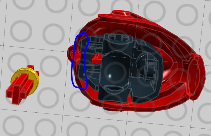

Part 87817 won't attach to Part 11270. even though I have then attaching in real life. Here is a picture for reference
When you attach it in real life, does it slide on effortlessly, or do you have to force/press it in? Looking in LDD, it does seem the back of the head would collide with the helmet.
In the attahced pic, I tried to arrange/align the head with the helmet and view from the underside and it looks very, very tight.
It does fit. But there is some resistance. I think the back of Stringer's helm flexes to fit since its a softer plastic. When I customized Stringer's helm to fit a visor. I was able to cut the back easily.
