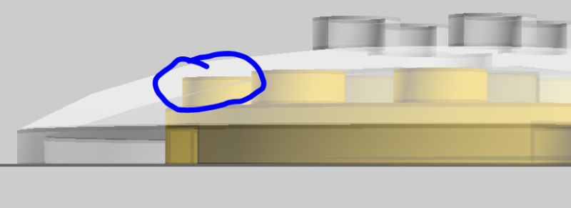

42610 Hub Ø11,2 X 7,84 cannot be attached to the top stud of 4733 Brick 1X1 W. 4 Knobs, even though it can be attached to any of the side studs. This attachment is used in 10192 Space Skulls, a set that was tailor-made to be built in a previous version of LEGO Digital Designer, suggesting that this attachment was once possible but for some reason cannot be done in the latest version (LDD 4.3.6).
This is because the top of the brick is concidered a "normal" brick stud, and those are generally not allowed at TLG to be connected to a Technic hole. A Technic hole is not really a good receptor for a stud since it does not allow for expansion/flex (as normal anti-studs do) and it does not connect to the stud through all of the studs length. Therefore Technic holes are mostly only allowed for decorations and such, i.e. small 1x1 round plates etc that act as headlights etc. It is not supposed to be used for any structural building, i.e. cannot "take up any load". Having said this, there are naturally exceptions in official TLG sets, but they are rare, so as I have understood the decision was made at the LDD Team to be conservative in allowing the connection between a technic hole and a stud.
(Then there is also the issues that the hole in a Technic brick is out of system by a fraction of a millimeter that would also cause the LDD Team to be conservative, but that is another matter).

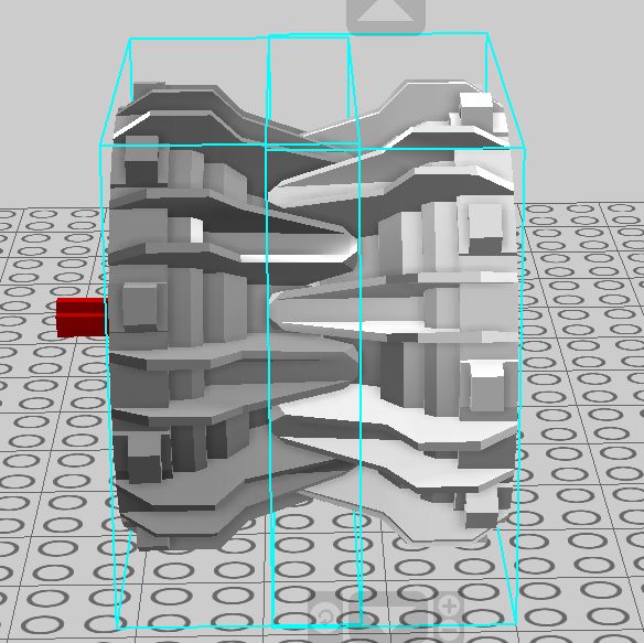

Halfway through making 13 more things with which to bother Calabar, I stumbled on this mad intersection bug, which seems to affect several "click hinge" parts when placed in system above or between knobs (I believe people like to call 'em "studs").
The LXF example includes a selection of click hinge "forks", with and without ½ knob offsets, in brick and plate form, plus a couple of other parts that I was able to place simply.
I also noticed that the "stubs" for the other part of the click hinges can also cause intersection issues. Mercifully, this only seems to affect modified plates such as 44301 and 44567.
Hopefully this is only an issue with the geometry and behaviour of these specific hinge shapes, and not a greater problem which would be a line-by-line code nightmare to fix.
LXF exAAAAAAAAAmple
