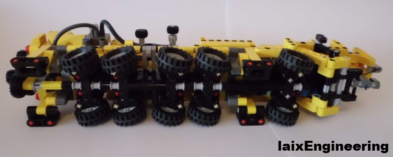

i am also pretty sure that when you connect it to a rc truck you can not drive backwards with this way of steering .
the truck will push the rear trailer wheels in the other direction then you want to drive.
i just made a semi lowloader with six axxes that al steer with a different steering angle by using 1 servo motor.
i tried lots of different ways to steer the axxes but this was the only way it works proper when its loaded with a crane or something else.
grtz Johnny

But this is based on a Nooteboom OSD semi low-loader and there aren't all wheels steered so i won't steer all wheels
I am working on a turning lock that if I drive backwards i don't get the wheels turned the wrong way

i managed to fit in the trailer .
a servo for steering
and a medium + gearbox for function 1 : ramps on back off the trailer operated by 1 mini la.
function 2 : 2 mini la that acts like feet on the front off the trailer .
i used tesame wheels as you except my trailer is 13 studs wide between wheels.

I'm not sure how implementable it would be into your mechanism and scale but just for future refrence, in order to get the proper ackerman geometry as mentioned by DLuders you need to have the steering arms at an angle as shown here:
Some of the methods as described by dr-spock would be the best way to control the steering tho i'm not sure they wouldn't be too intrusive to your design at the scale you are building. As yours is now has the benifit of being one of the simplest and most compact solutions for very small scales. Thanks for posting.

Hi Allan there is 1 problem because the gears cant handle a angle like this :sceptic: .
And i forgot 2 say that my trailer extends in length.

Yeah, they would have to be linked via a linkage rather than gears and I wasn't sure if it would be all that easy or necesary at this scale anyway. :classic:
