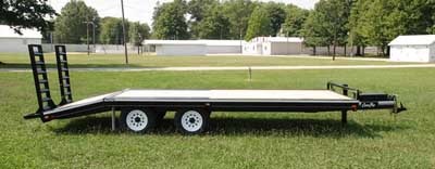

legotechnicblue Posted January 20, 2013 Author Posted January 20, 2013 (edited) Thank you. Now do you have any ideas on how to make a strong working crank jack? Aussie BJ can I see the rest of your trailer as I am also looking for a way to connect the hitch to the flatbed part. I am kind of going for something like this: But longer with three axles Edited January 20, 2013 by legotechnicblue Quote
