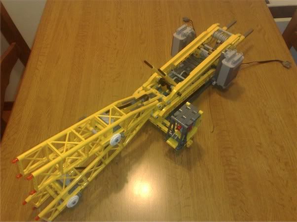

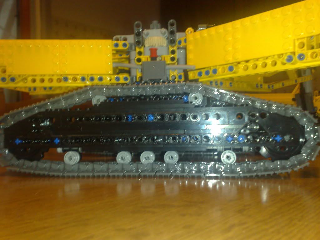

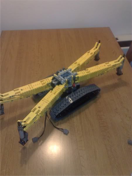

lirinco Posted June 19, 2012 Posted June 19, 2012 Hi guys, I wanted to introduce my new project, still in beta. the model reproduces the liebherr LR 1400 W2, used 8 motor, 4 pneumatic piston, 4 new piston and 1 gear pump, all controlled remotely. The length of the main arm is approximately 1.9 meters and the weight of the model is about 5,5kg. the model is completely to scale both the size and functions, including the system of retention of the lift arm by pneumatic pistons. I apologize for the pictures but we are in beta phase of the project and did not want to reveal too much, almno for now. Opinions and suggestions are welcome Quote

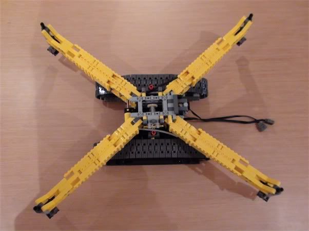

lirinco Posted June 20, 2012 Author Posted June 20, 2012 TNKs, further feature is the independent rotation of the crawler compared to the stabilizers and the super structure, as in the real version that allows the change of direction in confined spaces. Quote

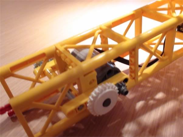

Milan Posted June 20, 2012 Posted June 20, 2012 Great and ambitious project! Those crane lattice sections, they are hold together by technic axle 2, but how sturdy are they when there are, lets say 8 or 10 sections connected togheter? Are they prone to breaking in that setup? Quote
Alasdair Ryan Posted June 20, 2012 Posted June 20, 2012 (edited) Great and ambitious project! Those crane lattice sections, they are hold together by technic axle 2, but how sturdy are they when there are, lets say 8 or 10 sections connected togheter? Are they prone to breaking in that setup? I don't think so,but i can't be sure. If you look at the picture below you can see two booms the one at the back is ment to help spread the load when the crane is lifting which should make the crane's boom less prone to breaking/bending. Edited June 20, 2012 by Alasdair Ryan Quote
lirinco Posted June 20, 2012 Author Posted June 20, 2012 milan hello, thanks for the welcome, my arm I already tried this with a previous model I made earlier, and had no problems with 40 sections. The junction of the sections with axes 2 does not generate problems in that the section works by compression, little and minimally in torsion or cutting. this is determined by the nature of the lattice-boom, which tends to compress the adjacent sections. thanks a lot anyway ..... I prefer those who see the problems from those who see only the results. tnks Hello, as you see in the picture the load of the boom is concentrated in its base, and the various sections above work for a compression of the other. Quote
Milan Posted June 20, 2012 Posted June 20, 2012 milan hello, thanks for the welcome, my arm I already tried this with a previous model I made earlier, and had no problems with 40 sections. The junction of the sections with axes 2 does not generate problems in that the section works by compression, little and minimally in torsion or cutting. this is determined by the nature of the lattice-boom, which tends to compress the adjacent sections. thanks a lot anyway ..... I prefer those who see the problems from those who see only the results. tnks Thanks for reply. Sorry i did not very precise in previous post. I meant are those 8-10-15 sections prone to break/bend when you hold them horisontal without any help by strings or brackets? I know they are not made for that purpose, but i am just curious. Quote
LEGO Train 12 Volts Posted June 20, 2012 Posted June 20, 2012 What a beautiful project and what a fantastic machine! My only suggestion is: finish as soon as you can! Quote
lirinco Posted June 20, 2012 Author Posted June 20, 2012 Thanks for reply. Sorry i did not very precise in previous post. I meant are those 8-10-15 sections prone to break/bend when you hold them horisontal without any help by strings or brackets? I know they are not made for that purpose, but i am just curious. hello , in the horizontal position there is a possibility that the boom can flex and to create an opening of the boom with subsequent rupture. The problem is limited by the relative weight of the boom and most remote from the situation that raises his arm in that position a load, but I've thought of different solutions, including the two most plausible are: Loctite and a transparent cable at the bottom of the boom to avoid the problem. TNKs Quote
Milan Posted June 20, 2012 Posted June 20, 2012 hello , in the horizontal position there is a possibility that the boom can flex and to create an opening of the boom with subsequent rupture. The problem is limited by the relative weight of the boom and most remote from the situation that raises his arm in that position a load, but I've thought of different solutions, including the two most plausible are: Loctite and a transparent cable at the bottom of the boom to avoid the problem. TNKs Yeah, i built few lattice booms, horisontal for a tower cranes, but they were made from plates and bricks. Pretty strong. Never tried with those lattice section parts. Will do sometime. Thks again Quote

kieran Posted June 25, 2012 Posted June 25, 2012 That's a big crane, will the pneumatics also be controlled remotely? if so how will the valves be controlled? looks really good with the stabilizers out in position. Quote
