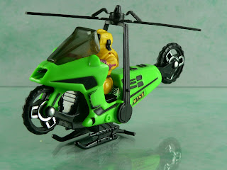

it brings back memory
looks like M.A.S.K. CONDOR
it's only rougher
I saw this picture once in google, but did not store in my memory as it was very far from engineering reality (eg. main rotor has no transmission like at autogiros, but there is no forward propulsion) I tried to make something similar but strictly tying myself to real engineering principles and functionality.
