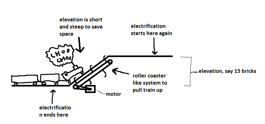

Sokratesz Posted March 27, 2012 Posted March 27, 2012 Hey all! Been awhile since I posted, am still in faraway lands without access to my LEGO :( I was just browsing through some of the new posts and got an idea. There are several guides available for getting a train to an elevation sufficient to cross tracks (13-14 bricks high IIRC) but long trains can take upwards of 2meters of slope to reliably make it to the top. Has anyone tried to make a multi-level (or otherwise elevated) railway using means other than the train motors themselves to move the trains to different levels? If you used a technic motor and and chain system similar to that found in roller coasters you could easily pull a very heavy train up a steep slope. It isn't very realistic of course, but it would save a lot of space, allow for longer trains and offer some nice options of integrating LEGO technic (mindstorms?) and trains. I'll use my paint skills to illustrate it. It would also allow you (for the 9v and 12v systems) to use a different transformer and thus different speed setting for the various levels since the electrification is interrupted on the slope. - Tim Quote
mostlytechnic Posted March 27, 2012 Posted March 27, 2012 It's an interesting idea, but you'd need to put the "hooks" that grab the chain on every car I'd think - I doubt the magnets would hold together on such a steep slope. Does seem like a nice way to get some change, especially on a larger layout where you could hide the hill behind a building or in a tunnel. Quote

cimddwc Posted March 27, 2012 Posted March 27, 2012 (edited) It does look like an intriguing idea, but you can't really have an abrupt change of the inclination: the tops of the cars will touch; and bogies aren't that flexible either, so unless you have only rolling stock with one axle on each end, well, even if it works with some axles lifted off the rails, it will certainly look odd... Also, the modern magnets (with full plastic casing) don't tilt much up and down, so they will lose contact easier, which would be a problem especially for the first cars of a long train, unless there's a motor in the back pushing it. So you'd rather need a smooth change of inclination, which also means more space. And there's another problem: the engine at the top will receive power again, but the cars are still hooked on the slope or below it and can't really be pulled. You'd have to match the speed of the slope and the engine pretty well. In the end, I'd say you're better off with a cog railway for steep inclines, but that won't be easy for existing trains, and not as space-saving as your idea... Edited March 27, 2012 by cimddwc Quote
Sokratesz Posted March 27, 2012 Author Posted March 27, 2012 (edited) A completely vertical lift system might be possible with mindstorms, although it would be a pretty large construction if you have long trains, but it would still save space and allow you to have multiple levels on top of each other. Hmmm I might have to look into that some time. You could even use the RCX to control the speed of the train on the stretches just before and after the lift such that it looks more natural and prevents disaster :) The magnet problem can be worked around but too steep an incline will indeed force the cars up against each other and maybe derail them, but again with for example side-support structures you could fix that. It wouldn't look very pretty though... - Tim Edited March 27, 2012 by Sokratesz Quote
harnbak Posted March 27, 2012 Posted March 27, 2012 (edited) On 3/27/2012 at 12:27 PM, cimddwc said: ...And there's another problem: the engine at the top will receive power again, but the cars are still hooked on the slope or below it and can't really be pulled. You'd have to match the speed of the slope and the engine pretty well... This could be solved by letting the chain pull further than the top: where c is conductor rail, x is pulling power for incline, and t transition between c and x. Maybe one should get inspiration from outside the lego world? Edited March 27, 2012 by harnbak Quote

roamingstop Posted March 27, 2012 Posted March 27, 2012 (edited) On 3/27/2012 at 11:04 AM, Sokratesz said: found in roller coasters you could easily pull a very heavy train up a steep slope. It isn't very realistic of course, Simple answer: it exists in Switzerland on the railway line between Luzern and Engelberg stations. The difficult bit will be the transition parts - but with slow curves it should be ok for most large bogeys. Edited March 27, 2012 by roamingstudio Quote

Sokratesz Posted March 28, 2012 Author Posted March 28, 2012 (edited) On 3/27/2012 at 7:33 PM, Slick Willie said: Won't work. Need to use the classic tight spiral Helix in one corner, with a switch at each level for the train to exit out onto each of the various levels. Downside is you need a heavy engine, and progressively lighter cars as you go to the rear of the train. Can you make a spiral like that? Is 16 curved pieces enough to up the height 15 bricks? I'd highly doubt it since curved inclines in general are super difficult for LEGO trains. As soon as I get home I'll have to start experimenting with the short slope roller coaster system and the entire train lift system, both seem very promising. *edit* oh and for the magnet problem, I just remembered how someone posted a solution where he put super strong industrial magnets between train couplings allowing the LEGO magnets to pull a much longer train. - Tim Edited March 28, 2012 by Sokratesz Quote
JamesP Posted March 29, 2012 Posted March 29, 2012 On 3/28/2012 at 10:20 AM, Sokratesz said: Can you make a spiral like that? Is 16 curved pieces enough to up the height 15 bricks? I'd highly doubt it since curved inclines in general are super difficult for LEGO trains. As soon as I get home I'll have to start experimenting with the short slope roller coaster system and the entire train lift system, both seem very promising. *edit* oh and for the magnet problem, I just remembered how someone posted a solution where he put super strong industrial magnets between train couplings allowing the LEGO magnets to pull a much longer train. - Tim Short answers, no 16 pieces of track are not enough to go up in. My spiral is 46 pieces long, with 15 pieces of straight each side. That's with ~6 motors to pull/push a 3 engine/6 car Santa Fe up (and down) the hill. (4 in the locos, 2 pushing). Brakes are not really optional, the best is to put about 2/3rds of the power at the head & then the rest on the tail. I have 2 locos which pull a brake van fitted with brakes, they add a lot to the control on a downhill train. The super magnet trick works well, I use ones from Lee Valley tools here in Canada, but they are not able to ship them by air. (yes, they are that strong!). I have never tried making a fully vertical arrangement, and I suspect it would be rather difficult as a pure lego solution. I have some lift bridges, and they are a bit fragile for lifting, and I suspect that they would not survive lifting a full train. James Quote

FreeBee Posted March 29, 2012 Posted March 29, 2012 (edited) Heres a link to a movie where i test having some trains driving up and down a slope. They all have only 1 motor. The slopes are built with 16 pieces of straight and curved track. If u keep the trains light enough they will make it up the slopes but the heavier ones (like the metroliner) won't make it on one motor. So the options are: - Make you trains very light - Use multiple motors - Or lengten the slopes Gr FreeBee Edited March 29, 2012 by FreeBee Quote
