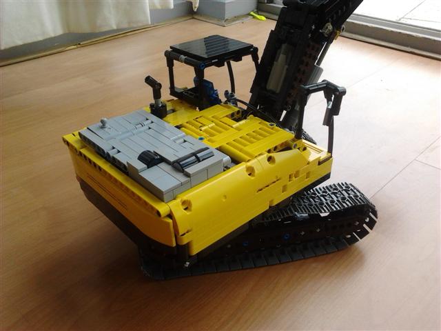

Hi guys, I tried to figure out what it the expense to build it from zero parts ( because I am building the Ultimate 8043 as well so I need my 8043 parts ) .
I also would like to make it in RED ( for those who needs I can share the xml parts for orange switched to red ) , only for the orange switched to red.
After a quick check seems the expense is damn huge... I feel something like 450€... is there anything wrong with me?
Do you suggest to buy any other set can lower my expense? That should not be the Unimog, because I don't make it Orange btw...
Ant suggestion is appreciated
I like how the boom actually looks proper and proportionate. Its not ugly or overpowering with the rest of the model. It just looks right.
I think I spent about 200 uk pounds,but I did have a lot of the parts myself.
Making this in red should be easy enough I would guess that 350 euro's should be enough to by the parts if you use the power function parts from the 8043.
Do you suggest me to buy any set wich you think it's good for that, maybe not for saving, but because of a lot of parts might go in that one?
I bought an extra copy of 8110 as a starting point. It comes with some of the PF components, lots of parts and lots of orange. I was able to take the extra 5x11 panels from it and make the snow plow for my existing 8110 at the same time. I was able to sell the tires and the pneumatics and make a lot of the money back.
