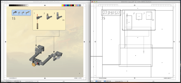

The reason for that is probably that rather than hosting scans (like they do for most of the older sets), newer sets often use the actual vector graphics. This means that they're scalable, but also massive file sizes. Personally I like having the scalable PDFs, since that means I can increase the clarity by zooming in at any time. But I understand how this would wreak havoc on an older, slower computer, so there are benefits to the scanned instructions as well. Perhaps LEGO could include multiple versions of each, one optimized for download speed and one with the full file so that users with faster computers can reap the benefits of these scalable graphics?
No, it's just the resolution of the embedded bitmap images that's changed. I checked out a couple just now.
Old manuals are just simple, full-page, relatively low resolution scans. And compressed.
Newer manuals are a mix of vector artwork (page layout, dividers, borders, numbers..) but the assembly illustrations are still bitmap graphics.
The newest manuals are the same as above, but with higher resolution embedded bitmaps.
If the manuals were 100% vector artwork, the file sizes would actually be much smaller, and you could print nearly any size you wanted. But the assembly illustrations are probably generated using their internal design tools, and then sent to the manual designers as high resolution bitmaps. To turn the 3D model into a 2D vector illustration might be very difficult unless they just redraw it by hand. Although they should finally realize that their color system is useless because you can't tell the difference between the different greys and blacks :hmpf:
