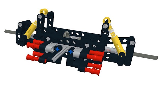

DLuders Posted February 12, 2012 Posted February 12, 2012 (edited) On the Sheepo's Garage website, there are details of this clever LEGO Technic Modular Platform System. He wrote, "Probably the most popular vehicles to build MOCs are the Supercars. We all love cars and the more fast and sports better, but if someone wants to make a Technic Supercar in big size and some complexity (scale 1/10 is the most used) and you don't have a good knowledge of the techniques, build it can be very complicated and end up as hopeless. "This system was created with the idea of ​​helping all those people who want to make a supercar at approx. scale 1/10 and still not have enough knowledge to start, or want to make a car with more advanced specs as Ackerman steering, camber angle and do not know how to do it. What is a Modular Platform System? "A modular platform system is a set of mechanical elements 100% compatible with each other to suit your needs. "In this case the system haves of three elements: front axles, central chassis and rear axles. These elements are designed so that you can combine as you like, you choose the front axle you want, the frame that you like and rear axle, join it directly and you have your perfect base for your Supercar!! "All axles are designed and tested for use 68.8x36 ZR tires which are very common and good aesthetics. "Important note: The instructions are made with SR 3D Builder because in LDD doesn't exist [for] some of the parts used, as the suspension arms 6L....You can download instructions (SR3D model) for all axles and chassis presented here: Download " There are many more details & pictures on his website. :thumbup: The MPS is well explained on Sheepo's : Edited February 13, 2012 by DLuders Quote

Sheepo Posted February 12, 2012 Posted February 12, 2012 (edited) I decided make this platform a few months ago because some people ask me about my supercars chassis. Also I don't like use Lego suspension hub(part x873c01) because it is very limited to make an axle, and too much people use it... And I want that they lose the fear to make an axle without this part. First two chassis: http://www.sheepo.es/2012/02/mps-chassis-1.html Edited February 18, 2012 by Sheepo Quote

Sheepo Posted February 12, 2012 Posted February 12, 2012 I have thought about doing this for trucks,its a nice idea i hope it works ok. I hope that too :) First rear axles http://www.sheepo.es/2012/02/mps-rear-axles-i-doublewishbone-i.html Quote

DLuders Posted February 15, 2012 Author Posted February 15, 2012 (edited) Sheepo has added even more Front Axle designs to his Lego Technic Modular Platform System (MPS) -- read more at Sheepo's Garage. The MPS download contains many more SR 3D Builder files than it did several days ago. Edited February 15, 2012 by DLuders Quote

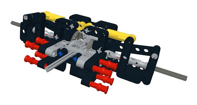

DLuders Posted February 18, 2012 Author Posted February 18, 2012 On his Brickshelf gallery, Blakbird posted big & beautiful 9 renders of Sheepo's Modular Platform System modules. They would make nice wallpapers for your computer desktop. Today, Sheepo has added even more MPS modules on his Sheepo's Garage website -- a Rear Live Axle (pictured below). He wrote that "Anyone are free to download and use this system. But if you use it I have a request, please send me a picture of your creation and MPS configuration used." Quote

Sheepo Posted February 18, 2012 Posted February 18, 2012 (edited) [...]He wrote that "Anyone are free to download and use this system. But if you use it I have a request, please send me a picture of your creation and MPS configuration used." I wrote that because I want to build a "Hall of Fame" gallery with all(or as many as possible) cars built using this MPS I'm still working my way through the renders and have the rear modules still to complete. Is anyone interested in seeing revolving animations of any of these? It is easy enough to make them. Once I've rendered all the modules, I'll make a few renders of completed chassis systems (3 modules). Any particular combination anyone wants to see? Many thanks for your work blakbird, the renders are fantastic!!! :thumbup: Please, can you make a pair of renders with this configurations? F.BD.1.1 + C.A.1 + R.AD.1.1B and F.A.1 + C.A.1 + R.CD.1 Thanks Edited February 18, 2012 by Sheepo Quote
