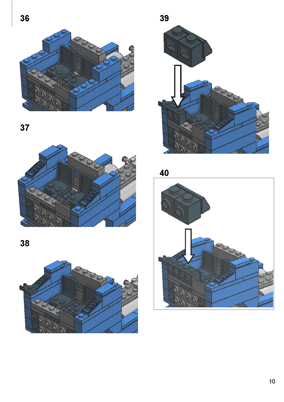

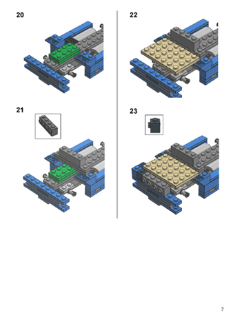

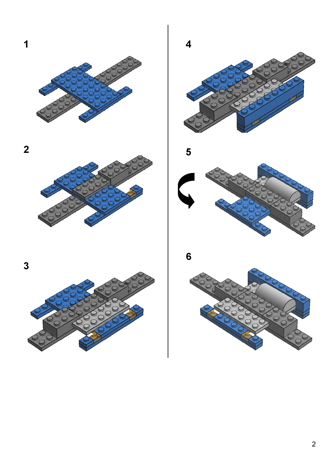

Superkalle Posted July 5, 2011 Posted July 5, 2011 In LDD, pictures of the parts needed for each step is included automatically when you chose View > Building Guide Mode > Generate HTML. Unfortunately, the generated HTML guide is pretty ugly, and the bricks per build steps can also sometimes be too many, or not show enough details. What I do is the following (for LDD): 1. Generated a Building Guide (View > Building Guide Mode) 2. Step through the model (using either arrow keys => one brick at a time, or Page Down => three bricks at a time. 3. Press Ctrl-K for each step that you like. An image is created. 4. Create a word document with one or more columns. 5. Drag and drop all the images. They will automatically get the right width. 6. Add headings, and format those to only show heading number (1, 2, 3 etc). That will create the base for you. Then you can add some arrow to show that the user much turn the model, have cleariying images of parts needed etc. Naturally some manual work, but I do it all in Word, and it's fast. Adding stickers or graphics I do in Corel PHOTO-paint (much better then Photoshop IMHO) Here are some samples. Quote

Superkalle Posted July 5, 2011 Posted July 5, 2011 On 7/5/2011 at 4:36 PM, Vincent Kessels said: Or, worse, creates a building instruction starting from the top down. This makes the instructions useless. And, for me, that happens more often then not. Yeah, I agree. What I usually do is to remove all "snotted" assemblies, so I just get the "skeleton". Then I generate instructions, and they generally turn out good. Then I do the snotted assemblies separate and assemble the whole thing in the end. It's some work, but it gives you fairly good results directly out of LDD. What I would really like however is more control over the building guide process, for example by using groups to direct the generation algorithm. Quote
