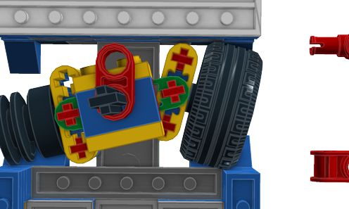

I have a suggestion for a steering mechanism that might work. I haven't tested it out yet, so i would say it's experimental.
I've attached a screenshot. I can send you the .ldd file if u want.
Hope i helped :)
P.S.
For some reason, there's a limitation to attachments to ... 17 kb?!?
Sorry for the crappy image :)
it's hard of me to explain with words how this steering mechanism is supposed to work.
The mounting point ( the axle where the cog wheel is ) should be connected to the steering motor.
When the axle turns, it pushes one holding bar in one direction ( inside) and the other holding bar in the opposite direction).
Thus the wheels themselves are turned, and their turning point is over the center of the black connector, where the bley peg is inserted.
Hope what i just explained is understandable.
In principle, it works just like an ordinary rack and pinion steering mechanism.

Unfortunately, this doesn work since the parallogram created is not "perfect". When the steering angle goes beyond about 20 degrees, it puts stress on the whole design. It might not be noticable they way you did it, but if you attach the two vertical studs on system plates using 2460, then it won't work.
Now, on to the next concept idea to test :classic:
Parallelogram is good, only the perpendicular connectors anchor to a part that starts three studs wide and decreases in the turn. The distance between the perpendicular connectors is fixed, hence the self destruction. It's harder to describe than to make work.
Yupp, I understand fully.
Question remain now: Is there a solution around this.
