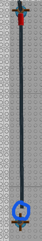

marsu211 Posted May 5, 2011 Author Posted May 5, 2011 To All, Well, the issue is not over yet! Attached a new LXF file for current situation. After playing around with Scaffolds and so, I am stuck at closing my square. Pictures: http://dev.tekilasoft.com/gallery2/main.php?g2_itemId=19314 Login: eurobricks pwd: bricks2011 Use with respect. It appears that the parts move in angle and these can not line-up correctly. When removing the base plate, or any plate used as it's base, the closing of the square might close, although not all parts are being connected. I need the plates as a base for my construction, and wish parts being connected together. Again, thank you for your efforts and your help already given and thank you in advance for future support. Best regards Patrick Closing_the_Square.lxf.zip Quote

Superkalle Posted May 5, 2011 Posted May 5, 2011 I don't know if something wrong the placement of the bricks in this particular file, but this is what I found. The ends don't seem to meet up. Quote

Calabar Posted May 5, 2011 Posted May 5, 2011 I don't know if something wrong the placement of the bricks in this particular file, but this is what I found. The ends don't seem to meet up. That's exactly what I mean with "disaligned" in my post #14! You image is surely more explicative. Quote
