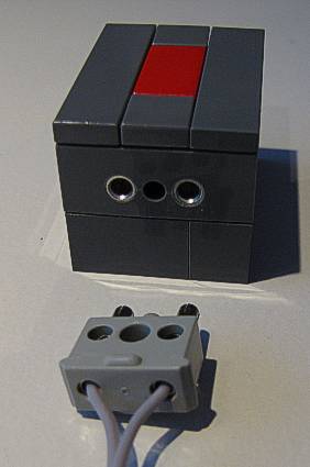

deejay Posted February 22, 2011 Author Posted February 22, 2011 Today i tried a new Connectortype on the Trackswitches. For the Lego Standard Connector. Look at the Picture. :) Quote
peterab Posted February 23, 2011 Posted February 23, 2011 Today i tried a new Connectortype on the Trackswitches. For the Lego Standard Connector. Look at the Picture. :) That's really nice. There are also plugs in the model train world of the same size, so non purists would be able to save some money, but purist could use the 12V leads. Quote

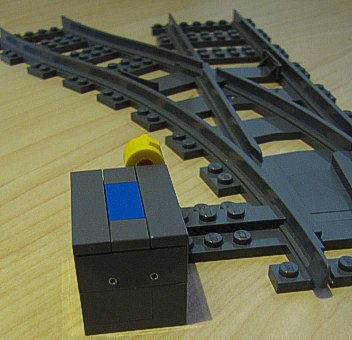

deejay Posted April 27, 2011 Author Posted April 27, 2011 Here another type of Switches. So i can put the Switches were i want. :) Quote
marsupilami Posted April 28, 2011 Posted April 28, 2011 (edited) You sir, are a genius! Your creations are looking very good. Edited April 28, 2011 by marsupilami Quote
baard Posted April 28, 2011 Posted April 28, 2011 Great work. Do you have to modify the Lego track at all? If not, this creation should be adapted and sold by TLC. Thanks for great videos Would want to buy some of these if possible Bård Quote
deejay Posted April 28, 2011 Author Posted April 28, 2011 Thanks a lot for the Comments. :) The Tracks must be modified a little bit. But not much. @ baard : you can write me when you´re interested. Quote

deejay Posted May 3, 2011 Author Posted May 3, 2011 (edited) When someone is interested: I have a Set including 8 Motorunits with Controlunit remaining. (Look Picture) Because i made a other for me with 16 Units. :) weichentuner@freenet.de Edited May 3, 2011 by deejay Quote
skaako Posted May 4, 2011 Posted May 4, 2011 (edited) When someone is interested: I have a Set including 8 Motorunits with Controlunit remaining. (Look Picture) Because i made a other for me with 16 Units. :) Hi there, your points motors look really good. Did you have to modify the switch so it would change with less friction? I had to do that with mine as the motors i use didn't have quite enough torque. Edited May 4, 2011 by skaako Quote
