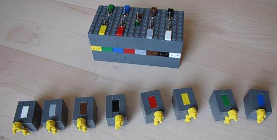

Okay, sorry. Now i try my best in English. (It´s not the Best) :)
There is a little micromotor inside. It is only switched the polarity.
Without limit because the switches are momentary.
It´s a lot of work. When you are interested you can call me.
When i have time, i´ll post some Pictures.

Pictures coming soon. :)
In the Moment i have only my own Control Panel. It looks a little bit different. It´s with 8 switches. But at the weekend i take Pictures.
Which Standard way connection do you prefer zuerihb? Infraredconnection is for me not possible. :)
Only the wired Connection. There are only D-Sub pins in a Lego Bracket. You can change the Wire with your own lengths. I have only about 1,5m.
Seany: what do you mean with clunky?
The Switch revert back, but the Tracks keep in his position. => The Switches are: up(groping) Tracks left, middle stay, down (groping) Tracks right

So, here are some Pictures. The second is the Controlpanel from my little son. I have 8 Switches inside.
The first Picture shows the Switch. I think it´s clunky enough. :) My Kidz can used them good.
Edited by deejay
So, here are some Pictures. The first is the Controlpanel from my little son. I have 8 Switches inside.
The Second Picture is the micromotor who ist inside the Switch.
The Third Picture shows the Switch. I think it´s clunky enough. :) My Kidz can used them good.
And the last Picture show my drilling device that everything is equal and sized perfect. :)
