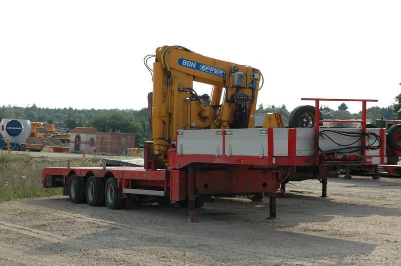

i differentiate in following classes.
minimum folding ability but very powerful
D70_01285.JPGPicture source
full folding, most used crane in real life
8703524e1d.jpgPicture source
extraordinary, very strong and huge and to heavy for normal trucks
3000%20DSB%2020090115%20072.JPGpicture source

Brickend, no offence but my opinion about the 8110 crane is based on 19 years building Cranes in real life and so my leveling rule is maybe a little bit higher than them of other people.i know that TLG will never offer a crane that is in my eyes perfect. but the minimum requirement should be that the end of the crane can touch the ground without problems. At this time iam not sure if it can touch the ground. The 8110 is surely a gourgeous model with great ideas, and good to play for kids,if they could pay the price. :laugh:
