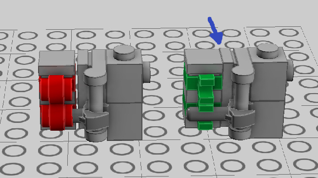

Mr. Lego-builder Posted November 27, 2010 Posted November 27, 2010 Hi everyone, I've been working on a project in LDD for a while now and one major problem has been bugging me. The building that I am working on has a large portion of brick-built lettering. I already have the lettering done following the Fire Brigade standards since it proved to be the easiest method, but LDD just would not let me condense the lettering. There are small gaps in the lettering that when expanded over many iterations (again, it is a large, long portion of text), it amounts to one whole stud in length. That presents a problem when implementing the text into the building. If anybody can help in getting rid of the gaps, that would be absolutely wonderful. You can find the file at this link. Notice the lack of actual lettering, since I camouflaged it. For it's not what the project is that matters, its the darn gaps that matter... If anybody is willing to put their LDD skills to work, I would greatly appreciate it. I really want to get this project up and running again and looking complete with the proper lettering! Quote
Superkalle Posted November 27, 2010 Posted November 27, 2010 iterations (again, it is a large, long portion of text), it amounts to one whole stud in length. That presents a problem when implementing the text into the building. Well, it seems you've bumped into some bug in the 4081 brick (1x1 plate with closed loop on the side). A work-around would be to replace 4081 with a 6019 or 61252 (1x1 plate with clip on side). Note also that there is a small height difference (blue arrow in picture below) that should be eliminated too. Maybe someone else here on the forum can help do that. EDIT: Hm, on second thought - it may not be a brick bug in that sense but more the "discreet jump" problem we've seen before? Quote
private_lego Posted November 28, 2010 Posted November 28, 2010 Make a solid connection with the 1x1 headlight brick (backside) Letter problem.lxf Quote
