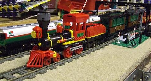

Carefree_Dude Posted October 2, 2010 Posted October 2, 2010 yup. wheels are the same as on the emerald night. You can actually just toss a PF motor on there, and that will do it. Of course, I tried to motorize it and this is what happened: Quote
Lego Otaku Posted October 2, 2010 Posted October 2, 2010 yup. wheels are the same as on the emerald night. You can actually just toss a PF motor on there, and that will do it. Of course, I tried to motorize it and this is what happened: I see you did a lot more than to add a motor. You added the extra wheels (blind wheels) that weren't used in original manual and more. I would think this looks a lot better than original version. Quote
vgsprites Posted October 2, 2010 Posted October 2, 2010 I was looking at the box art. Has anyone with the set tried to motorize it? Perhaps make a 9v motorized tender? Does it work on standard 9v tracks? Are the drivers compatible with the tracks? I made a simple red and black tender with my 9 volt motor. It didn't have enough weight to push the locomotive alone so I had to add weight in the form of dead AA batteries. The motor was able to push the train around my simple 9 volt oval. My girlfriend was pleased to see the train move on it's own power with the Toy Story characters on top. Nice build Goldenmasamune. Looks more like the actual train from the movie. Quote

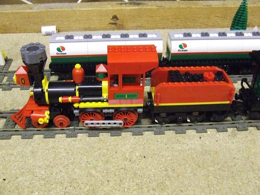

railway city Posted October 5, 2010 Posted October 5, 2010 I have! The driving wheels are now fixed to the boiler and do not rotate like a bogie, this means that the front bogie has to have side play to negotiate corners, the driving wheels have coupling rods, but not connecting rods. The tender is fitted with a 9 volt motor. Craig Second picture Quote
Carefree_Dude Posted October 5, 2010 Posted October 5, 2010 I love your idea of turning that tanker trunk set into train cars. Mind if I steal that idea and make a few changes? i'd get rid fo the train baseplate plate, make the tank taller (use red bricks instead of red plates maybe), and just connect the wheelsets to the technic holes on the bottom of the green pieces. Quote
railway city Posted October 5, 2010 Posted October 5, 2010 I don't mind you doing that at all, I build British trains and Toy Story is actually very tall compared with my usual rolling stock, I did toy with the idea of the stripe being a brick high instead of a plate, but decided against it. My intention was also to use a skeleton chassis like the one in the new cargo train set, but found that a 28 stud baseplate was much stronger and looks fine. Craig Quote
