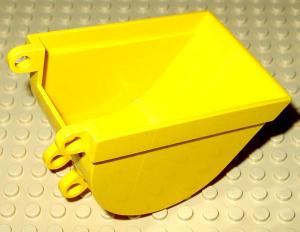

CP5670 Posted October 8, 2010 Posted October 8, 2010 The old yellow ones in the 80s (used in 8862 for example) may have worked well here. The larger, front loader bucket is somewhere between the 8294 and 8043 buckets in size, while the smaller one may be too small but is actually more appropriate for an excavator. And yes, this should be moved to the Technic section. Quote

DarkShadow73 Posted October 13, 2010 Author Posted October 13, 2010 Only problem is getting a hold of 8851 or 8862 bucket for my 8043. Eric I agree, I am a fan of real-life construction equipment so am big into the realistic Technic construction models of the past few years and so I know about the digging buckets typically used on excavators. The 8043's bucket as well as the 8294's bucket was more of a yard or mud bucket like you say. But in this case, thought I might try to installing the 8294 bucket on the 8043 after I build it just to see how it looks. From the instructions looks like it might work with a few different elements to hold it on, and actually might eliminate a bit of excess weight from the digging arm so the linear actuators don't get stressed as much as I am familiar with recall of the LA's on the 8043. I received a service pack for 1 of mine, but bought 4 total, 2 for reselling down the road a few years after retirement of this model and 2 to build. 1 of them I'm just going to install the originally packed LA's lubed with olive oil to possibly eliminate the friction issue that plagued the LA's, and just use it for display and install the service kit on the other one to use for a fun toy for a 37 yr old AFOL to play with... Quote
Jurgen Krooshoop Posted October 14, 2010 Posted October 14, 2010 I definately agree that the original 8043 bucket is way to big. Not just that, but the rotation point is in the wrong place and the bucket doesn't rotate in and out far enough. This causes the original 8043 to be very lousy at digging. That's why I replaced it with the 8294-bucket, which is a bit too small, but operates much better, making a better diggin'machine (cause that's what it is, right ?) Quote
Milan Posted October 14, 2010 Posted October 14, 2010 I also think it is way to big, I would use the one that Jurgen suggested, or the one (8862) that Blakbird suggested. Actually I used that yellow one from 8862 for my excavator, similar in size with this, but different in scale. Quote
