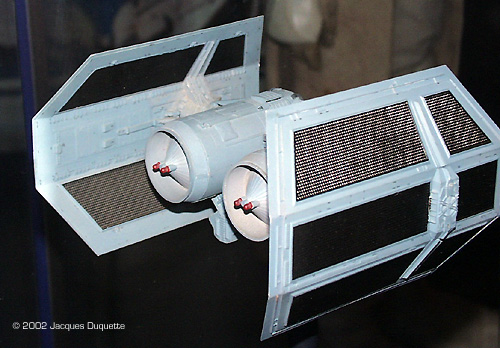

Other than the pods not being the same length, it should be noted that the engine arrangement actually looks like this:
Here's a reference picture showing the pods to be the same length (one of the models used in the film, I may add - certainly more reliable than CGI renderings!).
Also, the middle bit between the pods look just a bit too big. Otherwise, the details look spot on. I particularly like what you've done with the pylons.

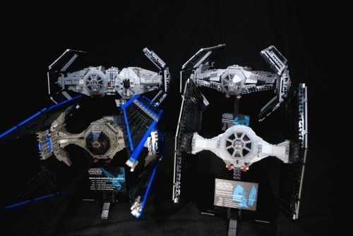

Very nice 'fleet' collection spacepilot3000 :thumbup:
I must say I do loike your version of this fine TIE.
This is one of my favorite ones in the SW fllet that is actually in the movies.
I so badly wish TLG will come out with a new version of this ship.
I absolutly agree. Being an epic ship and the fact it's still missing in my collection.
Although I hope it won't be a USC version.
The TIE Bomber looks good in that collection, spacepilot3000.
Have you ever thought about MODing the TIE Interceptor model to remove the blue pieces? The results look fantastic, in my opinion. Obviously I've MODed mine, and I've never had a moment of remorse.
Yes, I thought about that, and with your pic of the result I now think I have to do it as fast as possible.
Do you perhaps have a bricklink / partlist of the needed bricks to make it easy for me to remove blue ;-) ??
