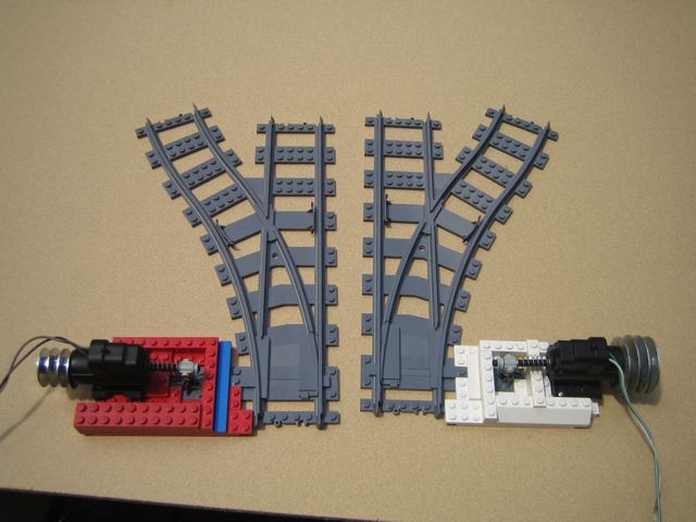

Is there any intrest in how to modify your Lego Train track switches to operate on 6 to 14 volts. Each Lego track switch has a DC solenoid added to the frame of the switch. Two wires connect each RR switch to an electric switch and a low voltage power supply. Or maybe someone has published how to do this.
Don

M8 I'd love to see how you have done this :)
Oh yes there is intrest, and btw on the internet it's photos or it didn't happen :tongue:
Photo of mod switches. Note the bricks for L & R are different to attach to the track.
Don
They're not subtle, I'd hoped for something easily hidden or below the baseboard like the Peco point motors. These are not much smaller than some of the power functions solutions. I wish I could afford the 9V micromotors, as I think they're the best solution I've seen, and they are a pure lego solution. If I consider a non-lego solution, it would have to have advantages over pure lego ones, such as being easily hidden or small. Still a good effort to get a working solution.
The best thing about the solenoids is : they are free
These were removed from Chevys automobile anti pollution controls that were sticking. My GM mechanic told me each repair shop replaces a few each week.
Don

I have a question, I am not so in to electronic devices, but I googled the tohe Solenoid and if I am right a pin is sliding in or out if you put power on it, or not?
Does it mean that you have to have power on it all the time to keep it in a certain state? Or does it just switch when you put power on it for a moment?
And what are you using to power these, 12volt transformator?
This looks very usable and cost efficient, but also a bit big as already mentioned.

You are correct. With the power on the plunger moves in and stays in until the power is turned off. When the power is turned off a coil spring pulls the plunger out.
The power supply I use is an old telephone supply : 7 volts 3 amps. You could use a auto battery charger.

Actually the best is to look for a latching solenoid - whose state changes depending upon the initial current supplied; but then it can stay in the alternate state without power (or minimal power).
Thanks both for the quick reply to my issue, one last question before I start to experiment myself. Did you modify the interior part of the switches to remove the friction of the switch, or is the solenoid able to overcome this friction, And will a 9 volt micromotor being able to work with an unmodified switch (is it strong enough)?

Yes, the stock switch has way too much friction for small motors or solenoids.
Snap off the back ( bottom ) of each switch. If it takes too much force , drill the plastic rivets 1 mm shorter.
Both the sliding arm and the switch frame need trimming with an Exacto blade.

The Peko point motors didn't use latching solenoids, as the points had a 'latching' spring in them. If you used a strong enough solenoid to overcome the friction of the Lego point, you wouldn't need to modify the point or use a latching solenoid. I guess both methods are worth considering.
