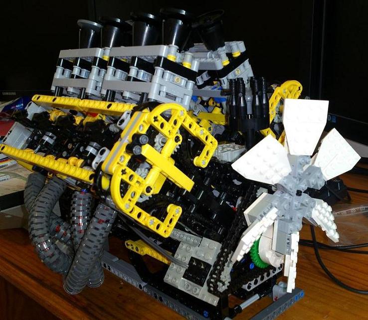

Tcp Posted February 3, 2015 Posted February 3, 2015 So I almost got all my parts for this build. I got the train regulator but didnt know I would need an ac adapter. So I found one specs are within limits but seems a lot weaker when I hook it up to my crane 42009 compared to the battery pack hook up. Is this normal? Or is the adapter incorrect? Input: 120VAC 60Hz 14W Output: 9vDC 800mA. Quote
Blakbird Posted February 3, 2015 Posted February 3, 2015 800mA is a little low, but should run the engine without any problems. I use a 1.2 Amp transformer at 12V. Using it for running the crane is probably a little low on power; should be at least an amp. Also make sure you have good clean terminals on the regulator because dirty terminals will lose voltage. Something is strange about the rating of your transformer. If it is 9V at 800mA, then thats 7.2 Watts, not 14 Watts. I don't know how they can claim 14W when it is only half that. Suspicious. Quote
bonox Posted February 3, 2015 Posted February 3, 2015 I don't know how they can claim 14W when it is only half that. Suspicious. the input is 14W, the output is 7.2W. 50% efficiency Quote

Tcp Posted February 10, 2015 Posted February 10, 2015 (edited) Wow look at what I started.... I'm at picture 117 and got a question. What is the timing on the cam gears for the 8 pistons? Say we start with the first two pistons (in order of install) with the pointy part of the gear pointing up (12o clock).... where does the next set of gears point (9o clock)? Then 6 then 3??? Edit: Nevermind I found it in the renderings thanks for all the great detail!!! Edited February 11, 2015 by Tcp Quote
Tcp Posted February 11, 2015 Posted February 11, 2015 on a different note and back to the moc, is anyone else having trouble finding 1x6 thin liftarms south of the equator? yeah they are hard to find and if you do find them its like a dollar each. Quote
bonox Posted February 11, 2015 Posted February 11, 2015 I think i've managed to get enough scraped together to start building and looking forward to it. I can't see why a cam alignment procedure from any real engine wouldn't work with this one, but you could begin by putting cylinder 1 at top dead centre, aligning the cam to have closed valves at that point and then turning it over to see if the rest of the bank lines up. I even have a 12V AC power supply to plug into my controller. Quote

Tcp Posted March 12, 2015 Posted March 12, 2015 Ive finally gotten to the end of the build... A very fun and great build!!! The only problem I encountered was with the flex axles for the headers. Says to use flex axle 16 32202 but they are too short cant fit the 27 pieces as noted in the instructions and doesnt reach the block on some of the heads. Going to try and get the axle 19.... Has anyone else had similar problems? Quote
Blakbird Posted March 12, 2015 Posted March 12, 2015 Ive finally gotten to the end of the build... A very fun and great build!!! The only problem I encountered was with the flex axles for the headers. Says to use flex axle 16 32202 but they are too short cant fit the 27 pieces as noted in the instructions and doesnt reach the block on some of the heads. Going to try and get the axle 19.... Has anyone else had similar problems? I just bought a spool of tubing and cut it to length after the plates were attached. Quote
bonox Posted March 13, 2015 Posted March 13, 2015 I used third party 19L axles for mine - it could do with a few more than 27 plates to cover the axle though. I'm happy with mine, but I would agree with BB about using plain tube instead. It's a small pain to trim the ends off another set of softies. Quote
