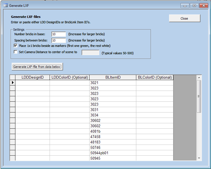

Yes it can. Well not import (yet), but you can cut and paste. This is how you do it.
1) Find the model in BrickLink (example) and copy & paste the inventory list into excel
2) take the column with ITEMId's and "clean it" (for example, there is often a pre-fix space before the ITEMId's).
3) Select a total of four columns in Excel, so that the BrickLinkID is the third column and the other three are empty (look at picture below)
3) Paste into LXF-generator, like below.
If the part in BrickLink does not exist in LDD, it will warn you about it.
The only problem is color, but I can look into that (bascially a lookup-function). Also the number of parts is not included, but I don't know if that is wanted? Can be an awful lot of parts.

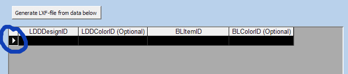

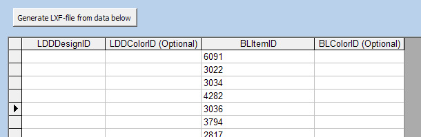

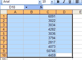

Yes. If you have four columns in excel, with the third containing the BL data, you then select all four columns and paste into LDD Manager (select The BL data will then be the third column and will paste correctly. Here's some pics.
Pic 1 - select the columns in Excel
Pic 2 - click on the arrow button in LDD Manager to the the row becomes black - then Ctrl-V
Pic 3 - The final result
It works! Thanks!

I've been using the "delete blanks" excel text-funtion to remove the first blank in the inventory, and found out that it should be "replace" instead.
