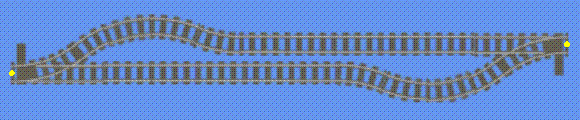

sebby Posted February 3, 2010 Posted February 3, 2010 (edited) I'm trying to rebuild my train station into something like my local train station. On one side the is the station and platform, then a foot bridge over two parallel tracks and the a small platform on the other side. This is a pic of basically what I'm trying to do, please remember this is a W.I.P. There will be a parallel track running next to the track shown. A few more pics can be found HERE At the moment I need the tracks to be 2 studs apart but to join up a a set of points not to far away from the station. Is this possible with standard straights and curves or would I need some flexy track or something else ??? Thanks in advance. [EDIT] I don't think it will matter to much but I will be using the RC track. Edited February 5, 2010 by TheBrickster Quote

Captain Zuloo Posted February 5, 2010 Posted February 5, 2010 FreeBee said: Maybe like this ? There ya go! I thought that put the tracks right next to each other, but it seems I was wrong. This is indeed your solution.Thanks FreeBee Quote
pe668 Posted February 5, 2010 Posted February 5, 2010 Points do not have to sit parallel to the straights. Here is another option which spaces the lines are little wider. Or this Quote

Captain Zuloo Posted February 6, 2010 Posted February 6, 2010 pe668 said: Or this How does it go for joining up at the other end? Quote
pe668 Posted February 6, 2010 Posted February 6, 2010 Captain Zuloo said: How does it go for joining up at the other end? Does it have to? There was no mention of being part of a loop. Stations can be end of the line. Besides over 10+ straights one stud out won't be an issue so just join it back up at the other end. Quote
