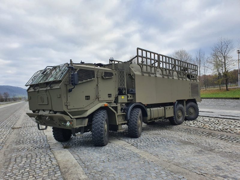

The supports serve to stabilize the entire machine to a perfect plane, due to the retractable telescopic masts. (My model does not contain them, I intentionaly used an incomplete piece of Starkom as a template (the one in the first photo) because I can't imitate those telescopic masts from Lego in any way and honestly I wouldn't even have anything to build them from anymore, for the construction of this model, at this stage, I have used up all the parts I have)
