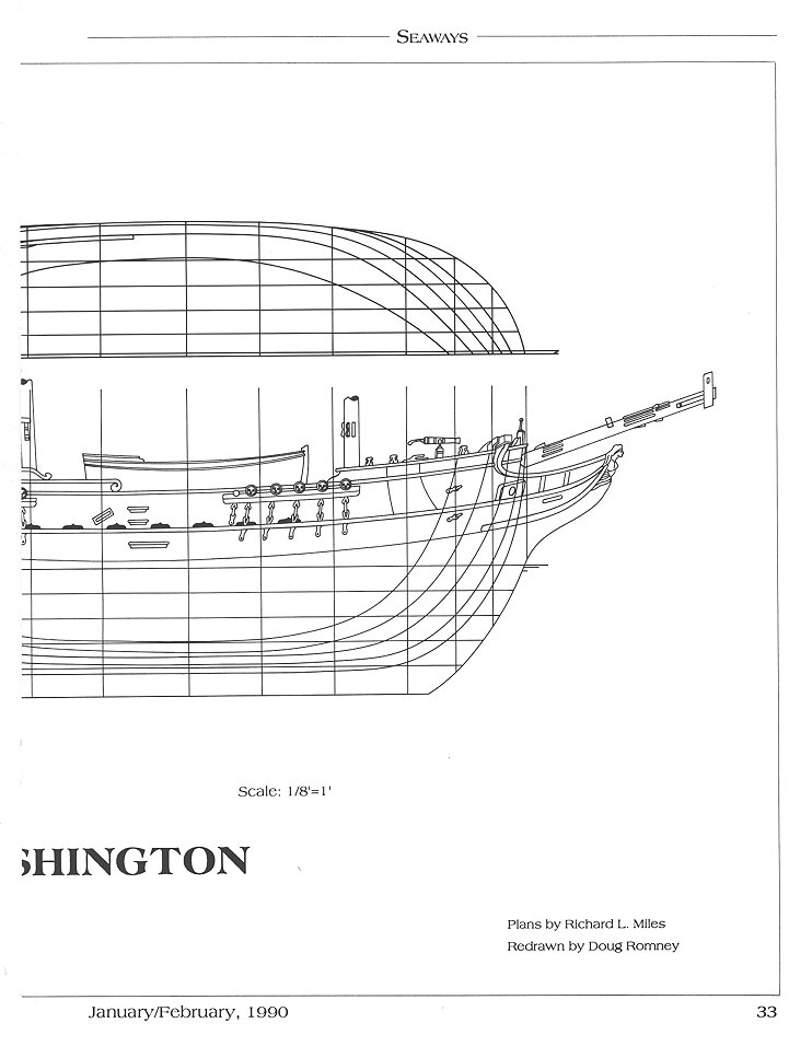

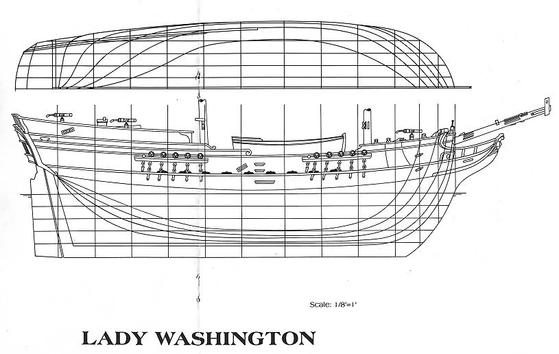

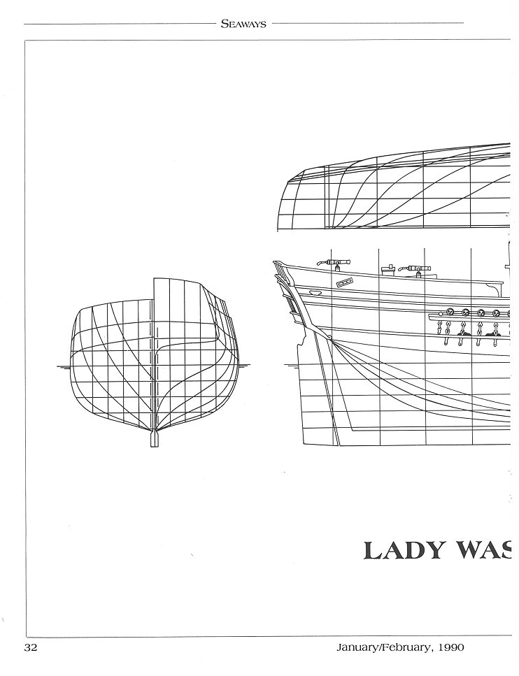

I found this a couple years ago, hope it helps.
Lady Washington General Plan
Lady Washington Plan Section 1
Lady Washington Plan Section 2
As to the best reference, i think you should look to the version that featured in Lego Pirates of the Caribbean: The Video Game... in terms of scale, it's probably the best one you'll find.

Thanks a lot, that is exactly what I was looking for. Thats really unfortunate with your data loss, I can send you my plans when I‘m ready.
Not specific to the Interceptor, but I find the Anatomy of a Ship series of books are very helpful. Lots of good details to work from, all scaled. They don't do one for the Interceptor/Lady Washington, but the Beagle would probably have a lot of common design.
Keep us updated on your progress, the Interceptor is a wonderful brig.
