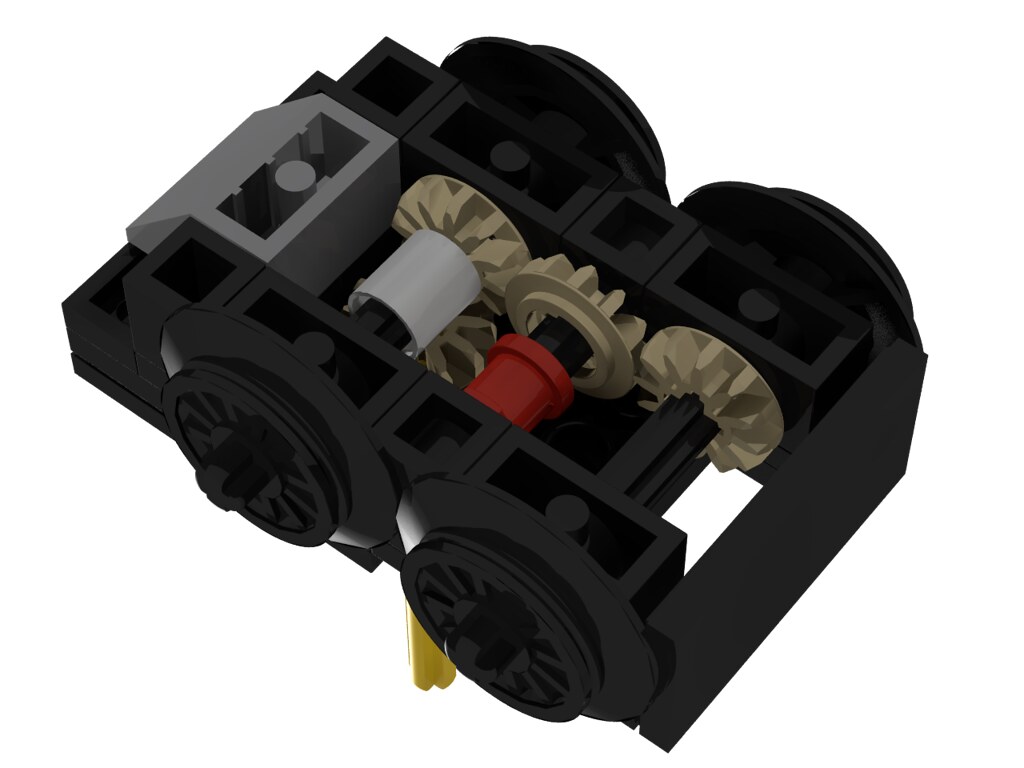

very nice! the small bogie is very cool, i have an idea for you how to make both axles driven:
small bogie
this drive works well, my 4 wide monorail uses it
small bogie_2
exterior looks the same

Thanks very much @XG BC I'll give that a go.
