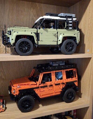

I have both and I loved the build process with both of them.  I don't buy many big lego sets so they were a treat to myself.
It's interesting that the mod/improvement thread for the Defender was circa 30 pages I recall with lots of brilliant and clever improvements.  In fact I would really recommend building the improved Defender model from that thread which fixes the gearbox and has a cool quick body-off mod.  You need to buy around 100 extra parts but it's well worth it.  In my view the gearbox in the original is not fit for purpose.  Improving the model doubled the fun for me easily.
The G500 mod/improvement thread is very small by comparison.  It's a great model with cool functionality and nothing really wrong that needs improvement.  My only modification is adding a lighting kit.
What's nice is they are the same scale so make a great pair to display together.
